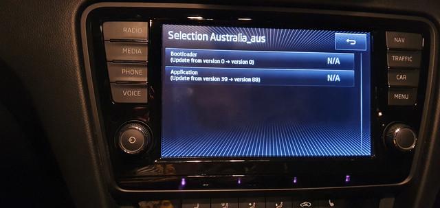

                • it appears the issue may be because it's a MIB1 system. some folk over at Briskoda suspect said unit doesnt allow for unlimited updates like the newer models. I managed to get it into service mode and it's detecting the update but it just wont let me update it! I managed to get a response from the dude in Melbourne too and he said they'd stopped trying back in 2019 but is now keen to have another crack at it. i just hope tinkering in service mode doesnt lead to bricking it. i'll keep trying and report back.

                    • it's recognising that theres a newer version, it's just not giving me the option to do so. i'll do some more searching tonight regarding a software update that'll allow the Nav update to work.

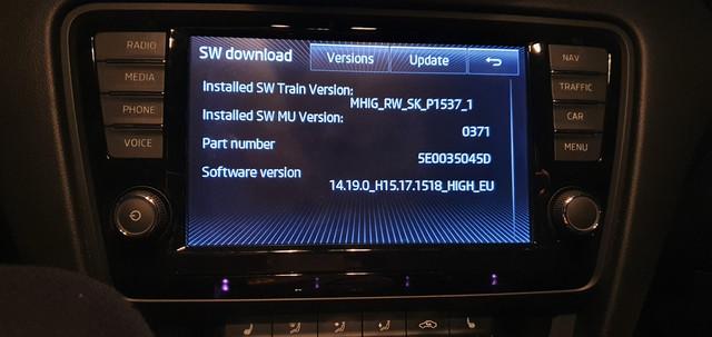

                      • Hi Hillbilly,
                        I finally got another chance to try. Took photos and looked at the recent issues of rednut. Well All my pictured match his. including the system software. I have not tried to do firmware updates. I saw no problems to try.
                        - my P90 software is on a Ultraplus 130mb/s 10 spec. in the root directory as all have said
                        Mine is the same. I can confirm that the nav system is via the harddisk in the car. No extra sd acrd required. ( my polo does run the sd card and won't work without it)
                        Rednut - have you solved? Anyone else ideas??
