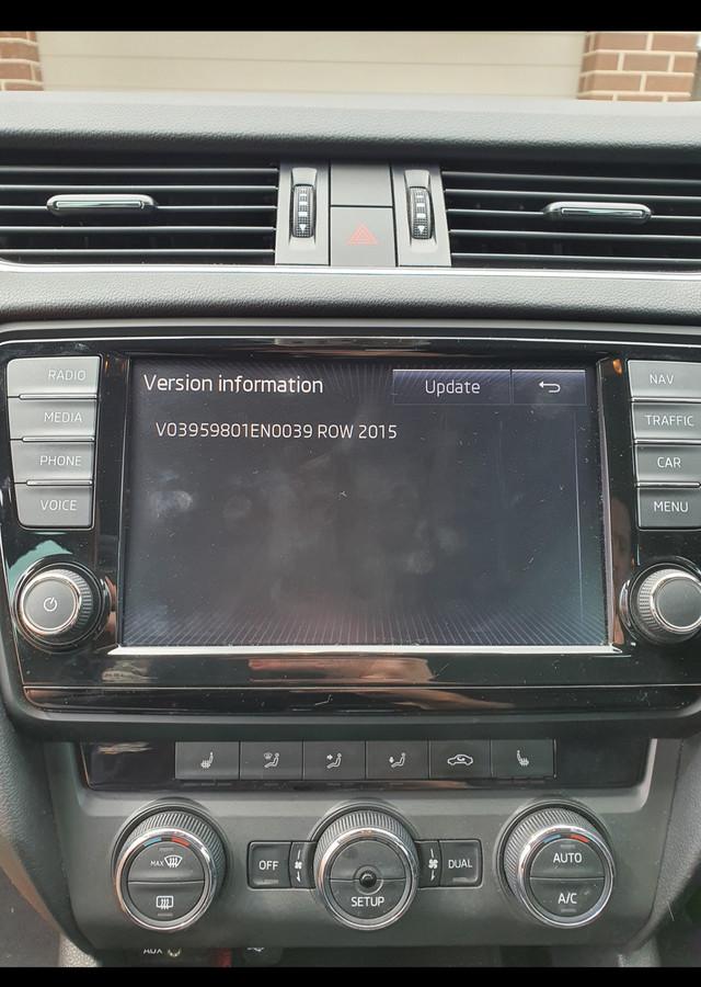

          What MMI do you have in the Skoda??? when you go to the site after it shows the car model it gives a choice of head units. What is the name of yours???
          Discover pro, Discover media or what

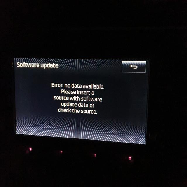

            • i appear to have bricked it. now i cant get into the nav at all and when i hit factory reset on navigation it doesnt appear to do anything.
              this is what comes up when i hit the nav now.
              this is what came up after trying to update (with new sd card as the previous one didnt work so i took it back.)

              • Ok a 32gb card does it and you cant skip any files So you download this file High12_P90_MRM_202045.zip to your hard drive
                You put a formatted 32gb Sd card into your computer
                You UNZIP the above file DIRECT to your SD card and when its done you should have ONLY these folders and one file on the card
                Mib1
                Mib2 Both are FOLDERS
                metainfo2.txt is obviously a text FILE
                Must be in root directory NOT in a folder
                Works for everyone else Eventually LOL
                Alternative method but much slower is to unzip to a folder on the HDD and then copy the above 3 from it to the SD card. Takes forever though. It wont find them if they are in another folder as only looks at the root of the card.
                I have used USB sticks with other stuff on them but as long as those three are on there and visible when you put it in car unit will find them
