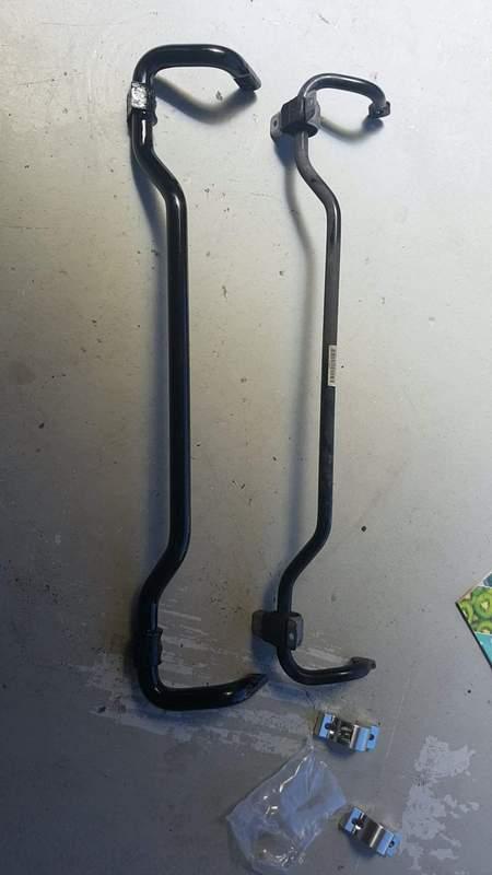

  • New 034 Motorsport Rear Sway vs Stock

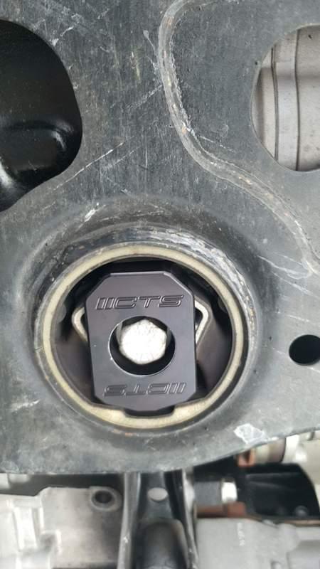

    CTS dogbone insert

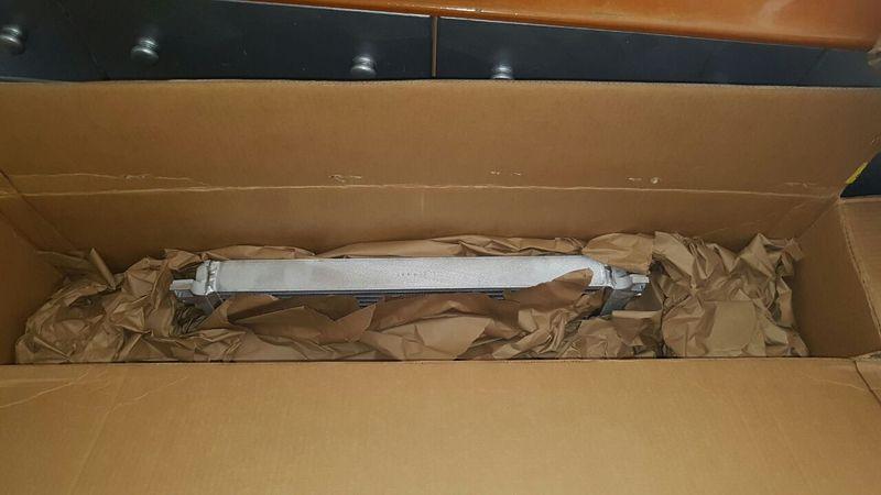

    CTS Intercooler still to go in

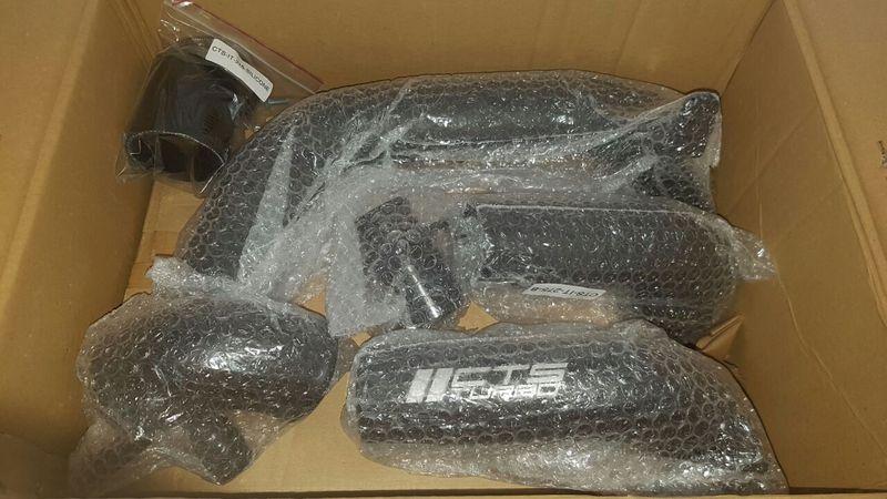

    CTS muffler delete and charge pipes etc. still to be fitted

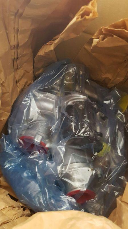

    CTS IS38 Turbo still to be fitted

          I must say I'm really interested to know how this all goes, even though I can't see myself doing much if anything like this myself
          Do you know for sure that that swaybar fits the Mk3 Octavia Wagon? I'm not saying it doesn't, it's just that I looked for models specifically for the Mk3 and couldn't find one. Also, would love to hear what the dogbone insert feels like. Any particular reason that you didn't go for the very popular one from 034?
          MY16.5 Octavia RS wagon, manual, Moon White + tech pack + 18" black pack.
          • Originally posted by pjam73 View Post
            If its anything like the Mk5/6 Golf and Mk2 Octavia (PQ35) then anything for the FWD MQB platform should fit, fine.
            Not including hers...
            • Originally posted by Mysticality View Post
              That's kind of what I mean - there are a lot of sway bars (I prefer the UK term anti-roll bar ) that say compatible with the Mk2 Octavia, but none mention the Mk3.
                Try looking at Mk7 Golf instead of Mk5/Mk6 Golf.
                • Mysticality is correct I purchased a Mk7 Golf GTI sway bar/ Anti Roll Bar it fits fine as you can see from the pic I have a wagon and the bar is for a hatch but they identical just the new one is thicker. Beauty of VAG is that you can dip into various parts bins
                  My mechanic took the car for a spin after fitting and said difference is night and day. it's adjustable too and has it set to firm which is what I like I'm keen to test it for myself and see the difference. I still need to fit my Eibach springs which should yield further improvements to handling.

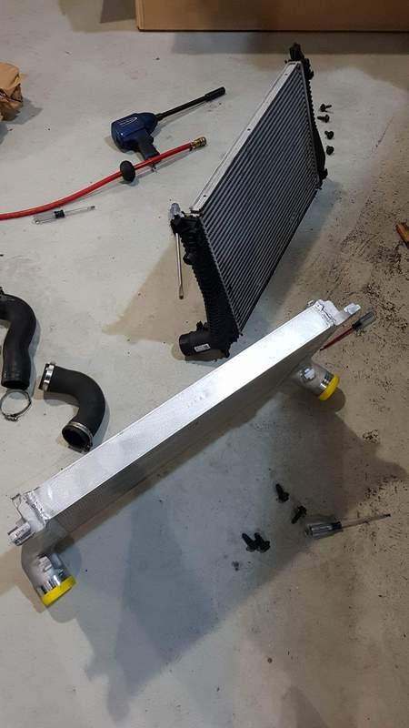

                      • And this should be reason enough to upgrade your intercooler. Look at the difference!

                        • Turbo being fitted today yay!
                          At this point Mechanic/ tuner is having more fun with the car. he took it for a spin after intercooler swap and says car is savage! he's said to start putting $$$ away for my clutch and LSD now as I'll need it

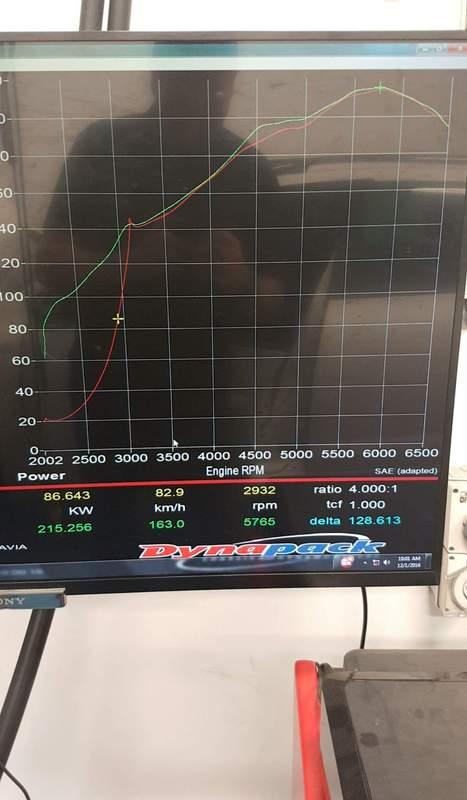

                              After more Mucking around with dyno bookings. Car is finally getting done.
                              Car Engine Mods:
                              Milltek TBE, CTS intake and Intercooler, GFB DV+
                              With Viezu stage 2 tune
                              car currently made 215KW = 288 HP at the wheels 4th gear run.
                              There's a decent surge between 2500 - 3500 before levelling out and becoming more linear.
                              Next:
                              car is currently being flashed back to stock map to run again as a benchmark
                              Then we'll be flashing the E-tuners Stage 2 map for comparison.
                              Then its off to get IS38, Denso Plugs Fitted and remapped with E-tuners IS38 Map and back at the dyno this evening for IS38 power run.
                              We currently have 2x IS38 maps their aggressive map and a milder version if clutch can't handle it.
                              If we need to use the milder tune, I'll retune again once I do the clutch with something better.

                              • 215kW at the wheel is very impressive. Any idea on torque values?
