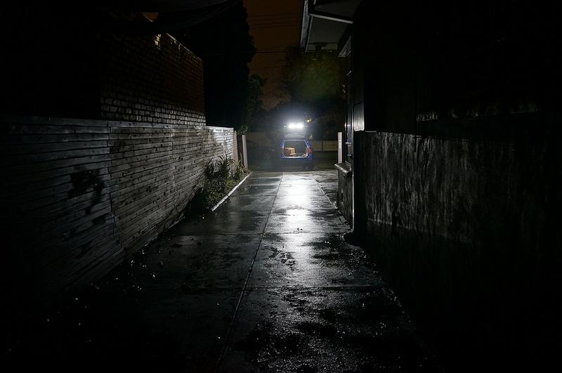

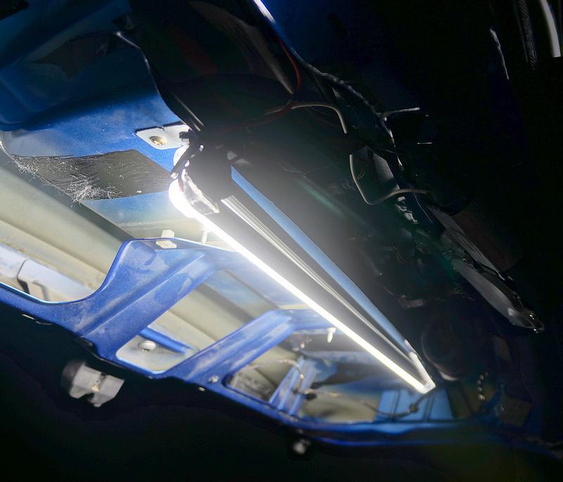

        Worklight mod:
        This came about as I will be using the car for my business, servicing bikes while mobile (more on this in the coming months, very exciting!) so I need the light in case I get caught on a job in low light, car parks, or in the non-daylight savings time evenings. The other reason is it makes it heaps easier to load the moto's in the trailer or use it when camping!
        I bought the 50cm led strips from ebay at a cost of $17 for the two. Then used a $2 switch from JayCar, linking them both to the 12v cigarette light circuit in boot. The job took me about an hour and a half including removing the neccessary trims, cutting and heat shrinking wires, and cutting and bending custom metal mounts.
        It makes quite a massive amount of light. You never want to look directly at them. Im hoping it wont startle drivers, but I also want to be seen. The top bit of the hatch will mask half the light going towards a passing driver..
        The two pictures above were taken at 8pm at night, and are completely unedited, shooting at only 3.5 aperture. You can see the wall where the hatch cuts off the light. Not bad!

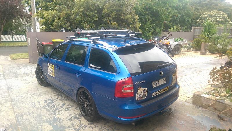

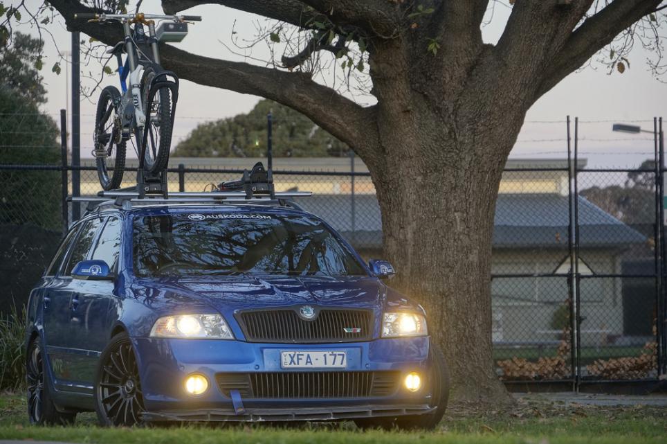

        SKODARU IS NO MORE!

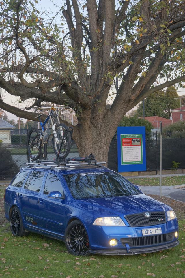

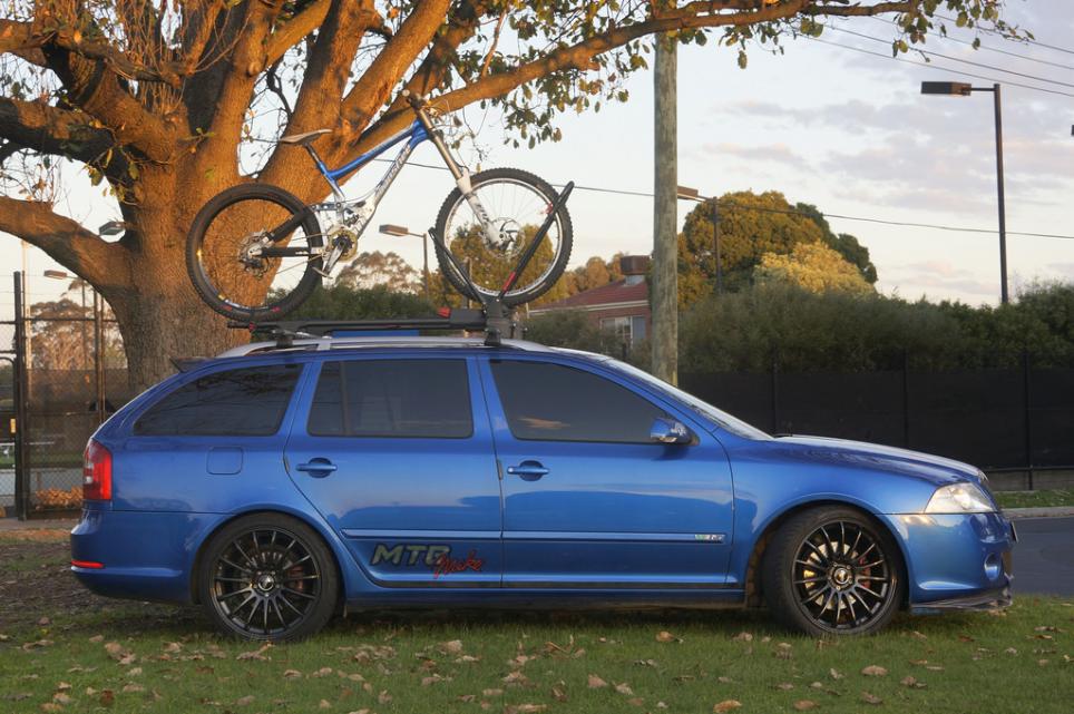

        Now its just Skodaddle, with a fresh new set of shoes, rubbers, and some fancy yet boss looking Yakima roof racks.
        I'm really loving this new look, and everyone else seems to as well. The wheels with two good tires came up cheap when I wasn't expecting them, and I liked them enough.
        Even though I didn't want to go 19" because handling can be poor, theres less give when going over rocky tracks, and tires are expensive, I thought I'd give them a go! On another note, the brakes look even smaller
        The rear tires are okay-ish! For the front's I went with the Kuhmo KU31's. I was almost going to buy some KU39's to try but I found these ones mega cheap on ebay, at a wheel shop close-by with only a few hundred k's put on them. They go quite well.
        I found a Thule crossbar set on eBay on bids, and actually convinced the guy to sell them to me on the day for $80. Good buy!
        I bought the Yakima racks direct for wholesale. Perks of the bike industry! They do look good, and very solid. I like that there are essentially four bars holding the bike, rather than one on the Thule's offering; should be much more confident on harsh driving. Im also glad to go for something that isn't on every farking car like the Thule's!!!
        Another thing to be noted is that ONLY in the pic below I have the THULE crossbars mounted. They are nicer and shorter. The other rack is some universal crap that had bad locks and was way too wide.... you might have noticed!
        What do you guy's think of the new look?

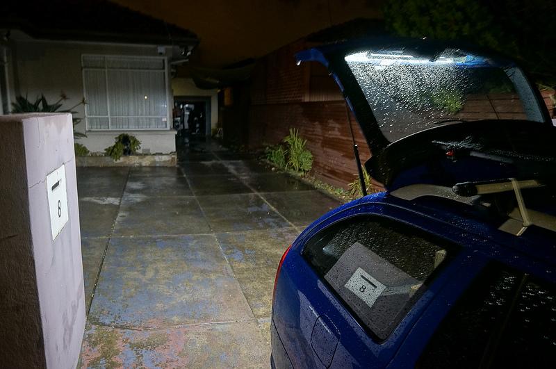

          • I like it! Might steal your boot light idea. I go fishing from time to time, the light would be a massive blessing! I'm thinking stealth install with a switch somewhere in the boot...
            • Originally posted by brad View Post
              It looks the same. I have no eye for detail at times.
              Should have gone to specsavers
              It only looks like that as I dont have the rear panel on the hatch. Bloody clips dont line up its so hard to get back on

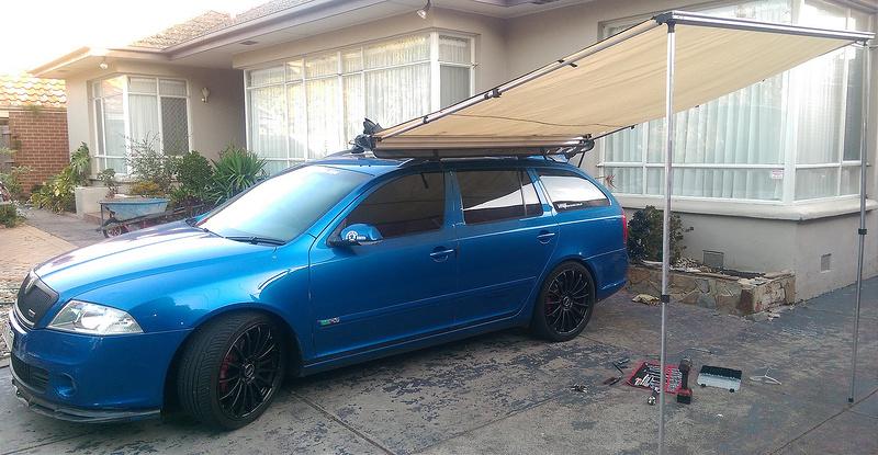

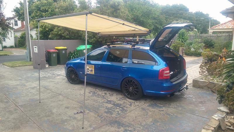

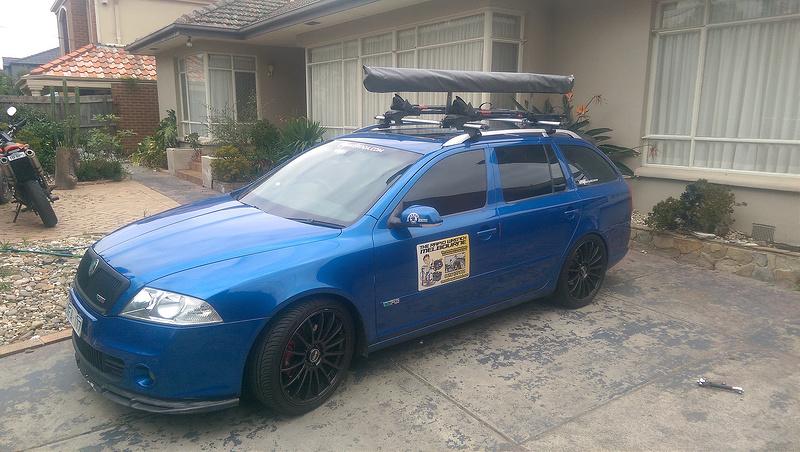

                  So I'm trying to get the car a little more ready with an 2x2m awning. $129 on eBay. Its a little fiddly to open and close with one person, but I got better at it. Only about 90-120 seconds to open or close.

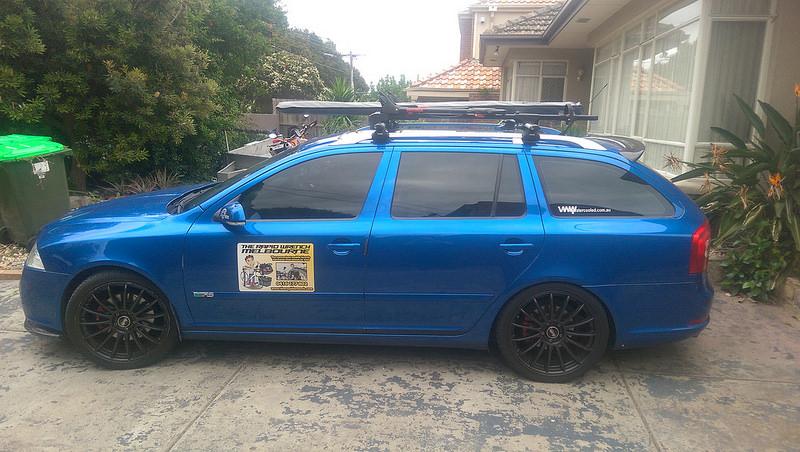

                  First I had it mounted on the end of the racks like this
                  Since they are designed for high 4wd's it was kinda low. I ended up fixing on some 350mm fence hinges to the rack to achieve a bunch of things.
                  1. It doesn't sit at the side looked retarded
                  2. It sits in the middle so the 11kg doesn't trying and weigh the car over the edge of a cliff
                  3. It gets me the extra head height so it actually does the job properly
                  4. Rain will land on top of the car, not go straight through the doors to the seats lol
                  Result (notice the temporary marketing magnets before I get the car wrapped):
