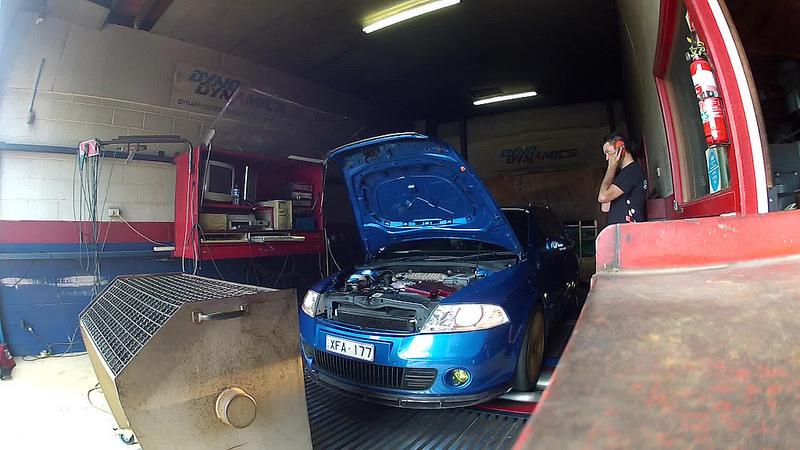

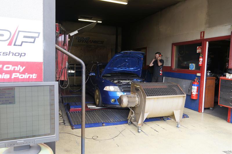

    • Today I hit up the HPF Dyno Day in Dandenong. It was an awesome morning with a dj, amazing rides (some so exotic), free red bull, snags, and the dyno's.
      My first time ever doing a dyno
      Here she goes.
      Make some noise!

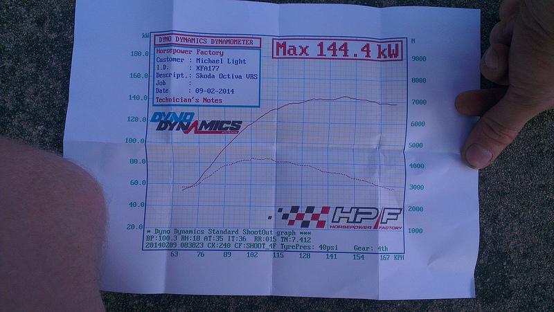

      Sigh... Not really anything near what I was hoping for, even after dropping my expectations with the heat and all. I noticed that the air fuel ratio was really messed at some points, and also I was gaining a degree in the inlet... Not too bad I guess. I definately need to do a carbon clean after this, remove the whole manifold etc. Also will have to fully fix the hpfp leak, and fix the kinked intercooler charge pipe hose. There is also a bad hesitation happening in 2nd sometimes at WOT. Seems like a boost leak

      • How did you end up with less than stock kw?
        I thought you were on a BlueFin stage 1?

          It's measured at the wheels, not the flywheel. There's a significant drivetrain loss when going on a Dyno. To put it in perspective a GIAC Stage 1+ Mk5 GTI made 146atw but would've had around 190 at the flywheel. Plus, every Dyno is different and as posted above, Mike is having issues with the car since the Fuel Pump.

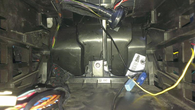

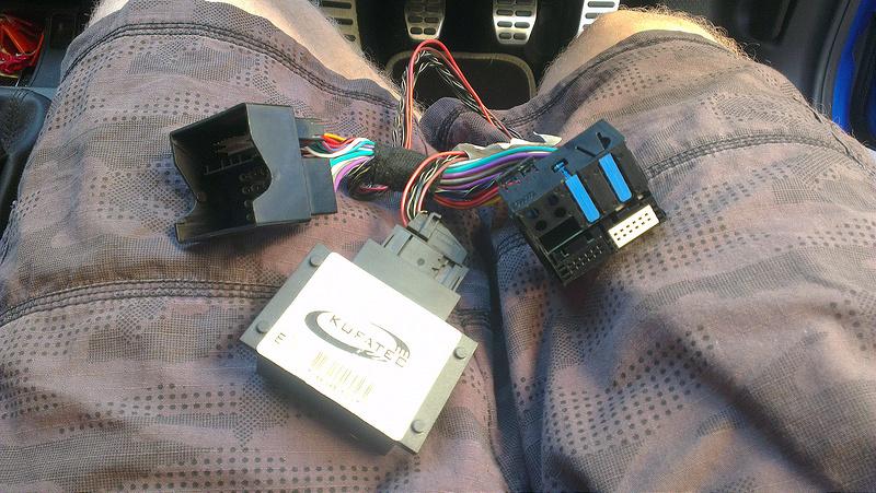

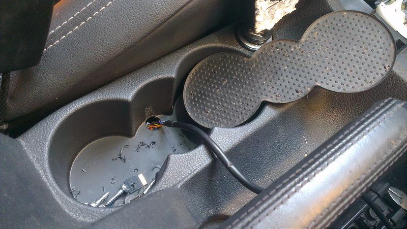

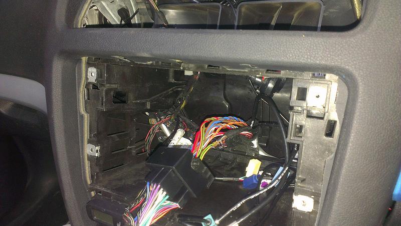

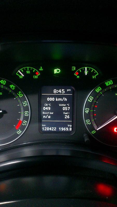

              Today I received the Kufatec E-MFA add-on second hand from someone on here. It gives extra info from the cars MFD such as fuel in liters, boost (although for some reason doesnt work with petrol cars), voltages, water and coolant temps, and also logs 0-100 times and a few more things. And you can play that old Nokia game, Snake

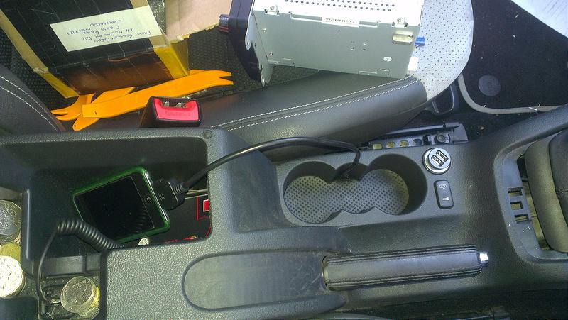

              Didn't take to long to install, its plug and play. But I had to spend over an hour move things around and zip tying. Then I had to cut out the back part of the head unit cage to make space for wires (it already had to be jammed in because of the DNS-810 being deep. I also had to cut a section out to the side to fit the Kufatec... Looks so dodgy. I'm lucky I didn't snag a wire...
              Cut the end
              Next, you can see the section on the left I chopped out...
              Cool! Definitely need to play with this more.
              I also made the access better to my iPod and cable
              Then I made a nice hole to access the USB drive port

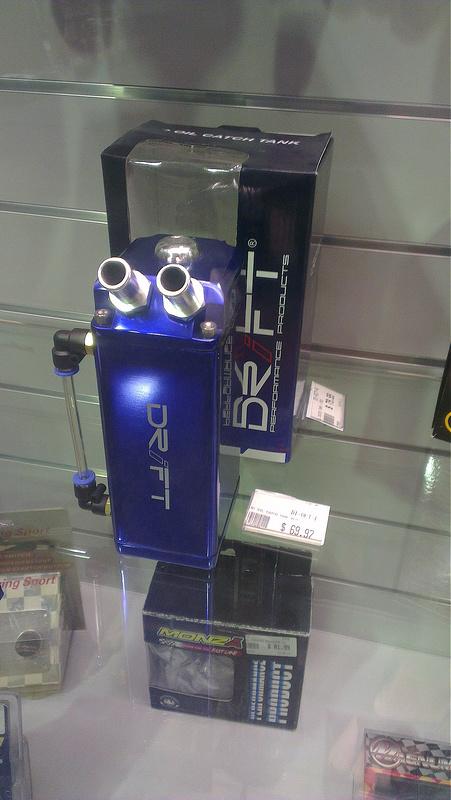

                    It's a catch-can. Should get a proper one made for our cars though.
                    • Originally posted by Deadpool View Post
                      Next question what does it do /why is it good/helpful?
                      • catch can I believe.
                        Mike, have you had a borescope into your inlet to see how it looks? They are pretty cheap at Aliexpress.
                        I've water sprayed mine just before the last 2 oil changes & it's definately more sprightly afterwards. The first one was about a litre of straight water (because I've run straight water injection previously). Last time was a litre of 50:50 water:turps.
                        I can see water injection in your future.
                        re: the catch can. I reckon you'd be better off looking for a cheap 2nd hand name brand unit. Maybe from one of the US forums?
                        • Originally posted by MountainBikeMike View Post
                          Now does anyone know the difference between these cheap ****7ers and the proper ones that Dub Addiction sells???
                          The propper Catch cans (42DD) have a filter/gause inside that catches more of the vaporised oil in the air passing through it. SO it Catches more basically.
                          Also has the option of a tap on the bottom for easy emptying and come as a kit with all the bits to install on a VW var
                          • Brad, how does a liter of water and girls not find it's way in to the pistons? How do you drain it out? Also, the process has to be good enough to clean the valves as well and you have to be able to crank the motor to get to the valves
                            Cool that's what I was looking to hear. I need a proper vw kit anyway to get the Pcv plate with it. There's hardly any way I could fabricate mounts on to the current bsh pcv to make it neat enough.
