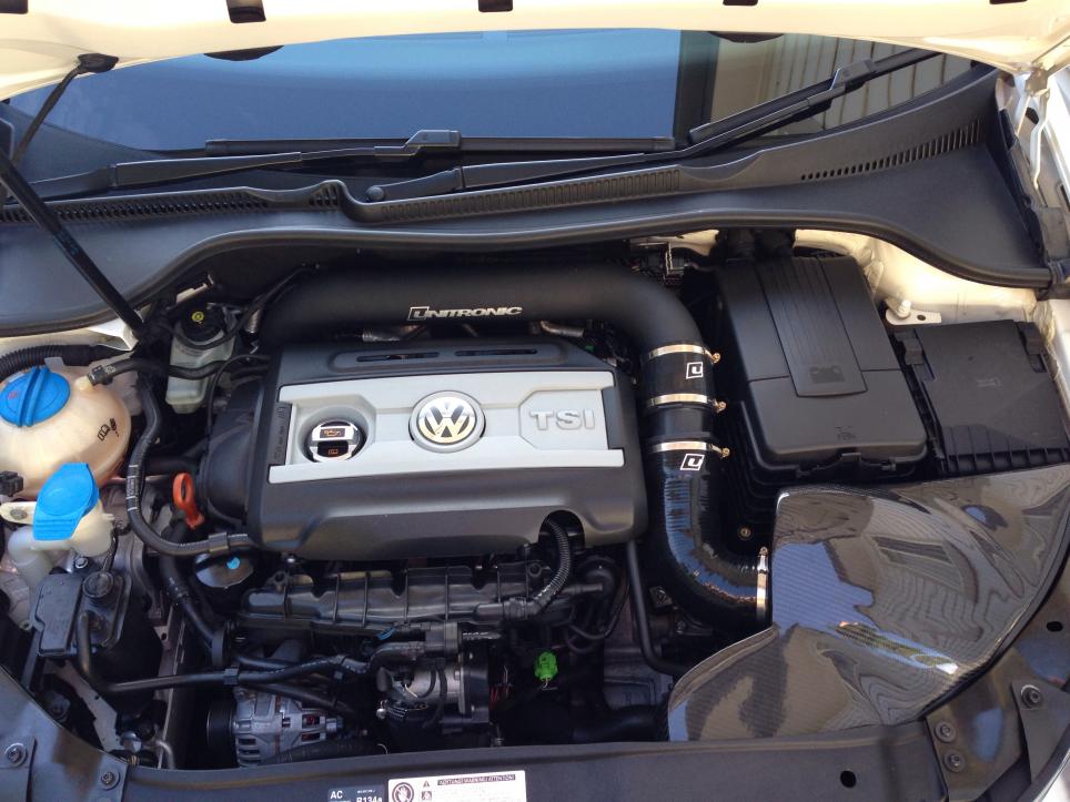

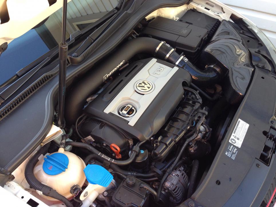

                • Up to my old tricks again....playing with intakes to make a custom hybrid version.
                  The Unitronic intake is great but i was never 100% happy with the exposed air filter, even though it had a heat shroud fitted.
                  So now its got a carbon fibre enclosed shroud to keep the heat away and the boys in blue happy. A bit of bling too
