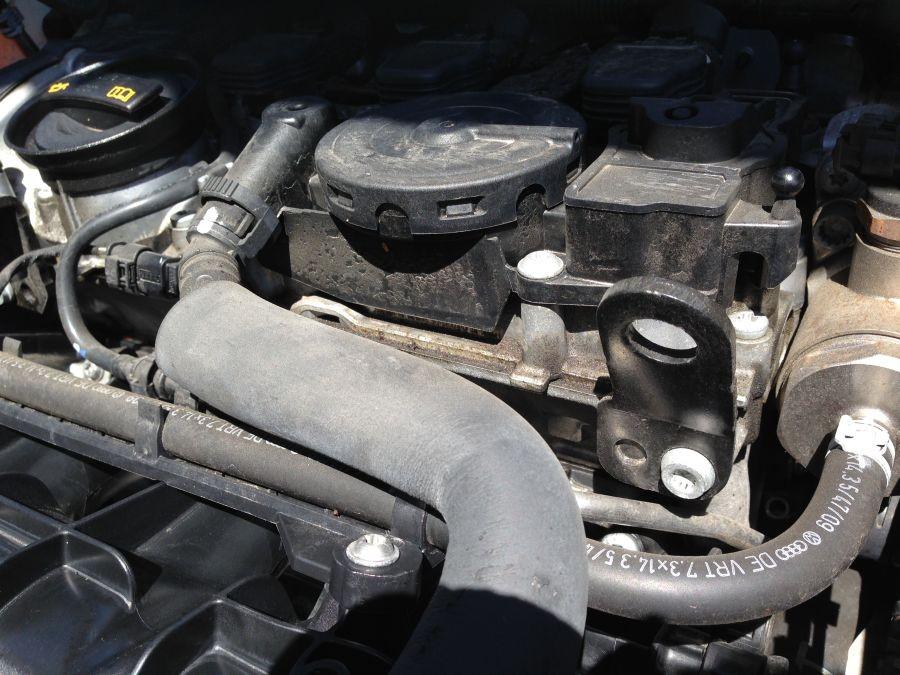

    Upon driving it, I noticed the RCD510 would turn off and then back on every minute or so. Hmmm what’s going on here. I took my VCDS cable out and it diagnosed a faulty ignition switch. Apart from the ignition switch errors (4 errors in total relating to the switch) the VCDS scan came back clear. An initial order with ECS Tuning was made for the ignition switch and several other items like a fuel filter, spark plugs, air filter, cabin filter etc. Took about 3 hours to replace the ignition switch (absolute bitch to get it out) but all is now good and the RCD510 no longer turns off.

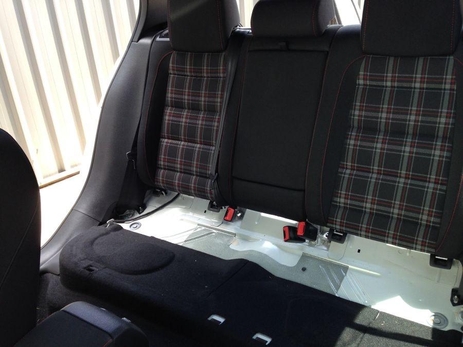

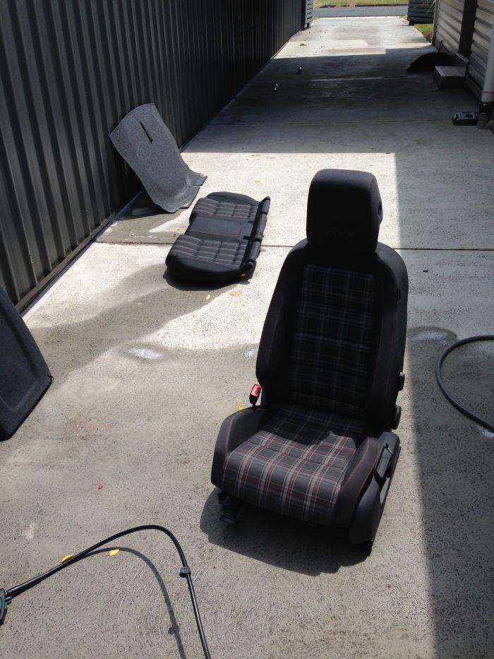

    After getting the car home, the cleaning begun. I removed the seats (front and rear) and they all got a shampoo, scrub and blast with the Gerni. They weren’t too dirty, but I wanted them as clean as I could get them. Taking the seats out also allowed me to give the carpet a really good clean too. The seats came up really clean and bright, but they took AGES to dry. The foam must be really dense. I have cleaned many car seats in the past and nothing has ever taken as long as these ones to dry.

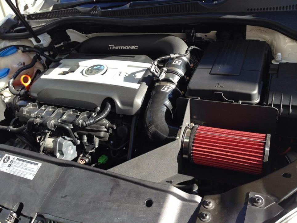

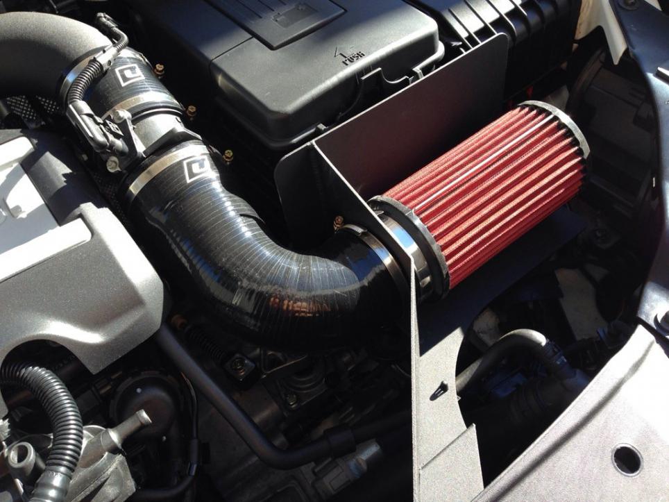

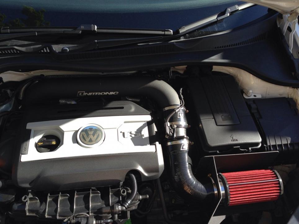

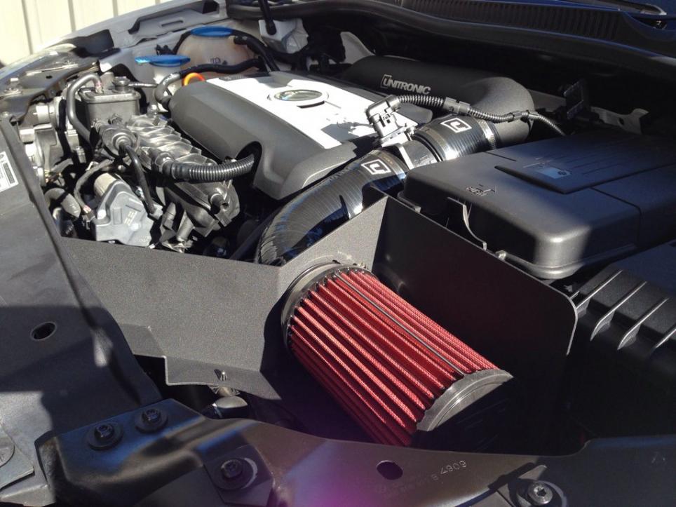

    Unitronic Intake:
    Interior pulled to bits for shampoo and high pressure clean:

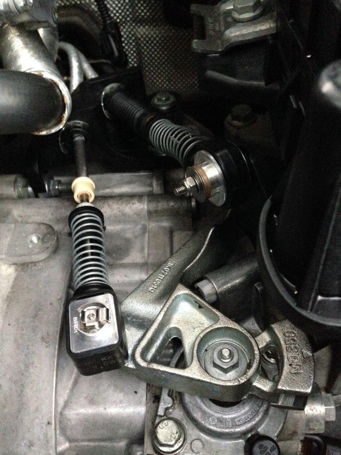

    42DD shifter bushings and Verdict Motorsport bracket bushings:

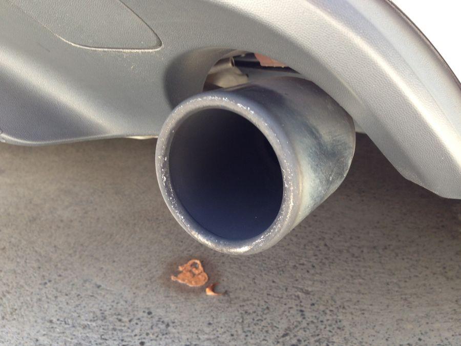

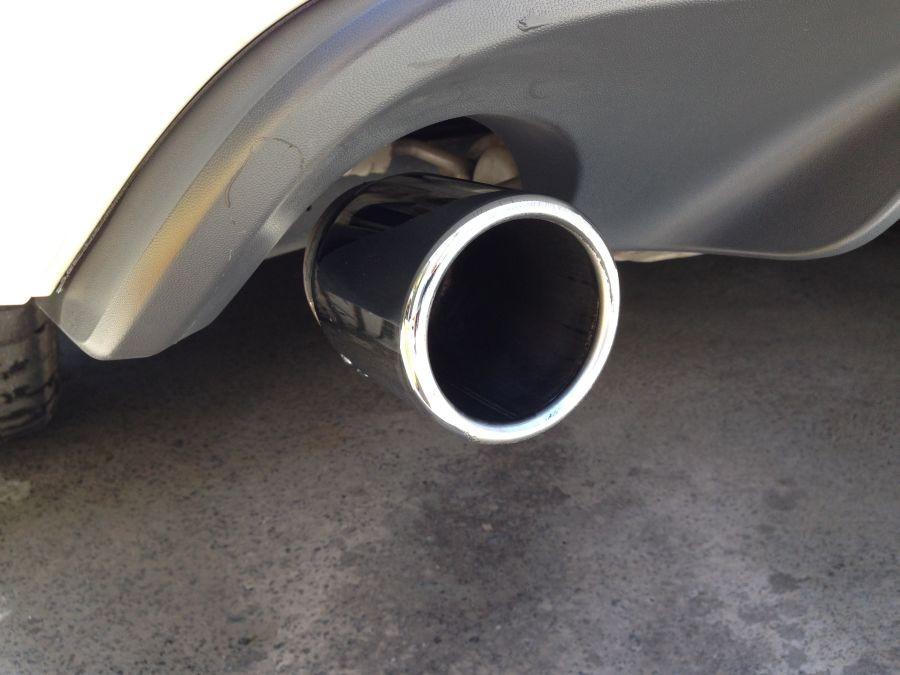

    Dirty Exhaust Tips (don't think they had ever been cleaned). Took about 15 mins each to get them clean again.

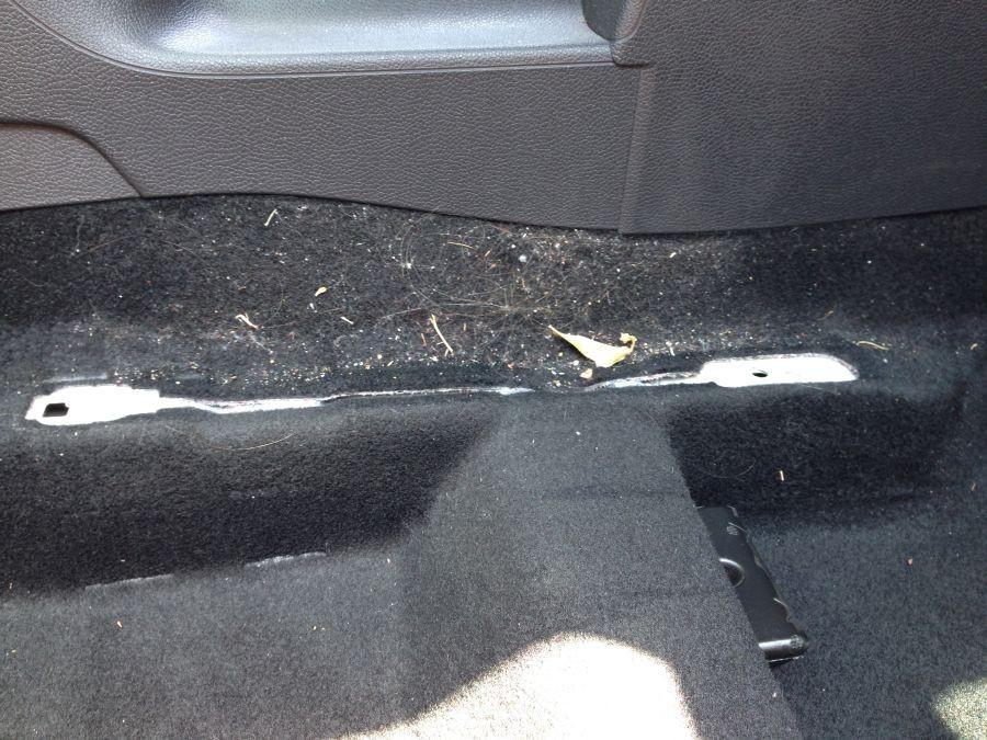

    More random dirt inside and engine bay (all clean now):

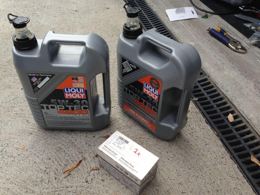

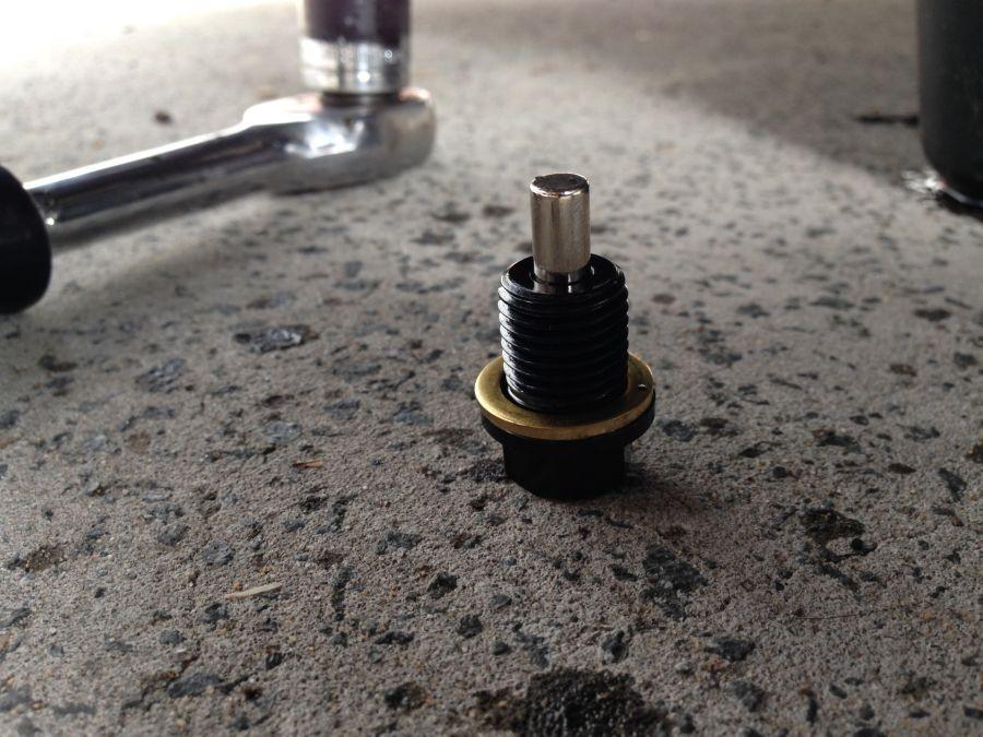

    Time for some service/maintenance items:

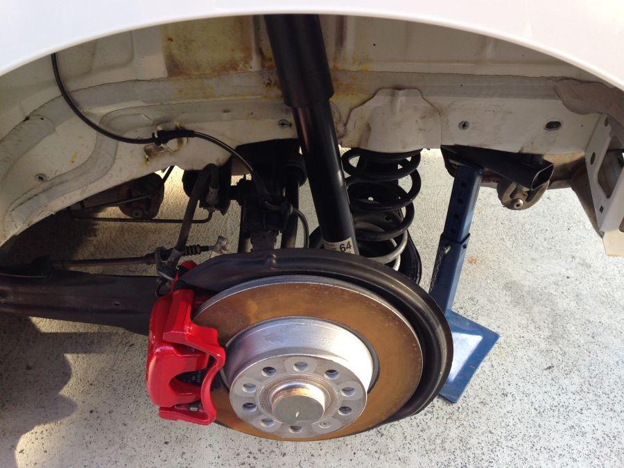

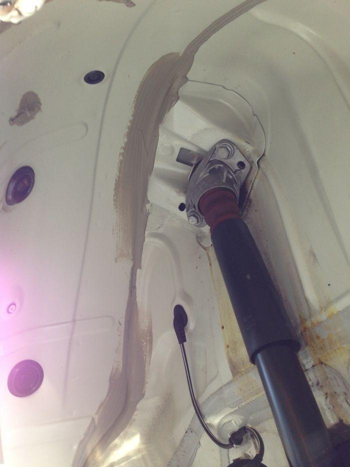

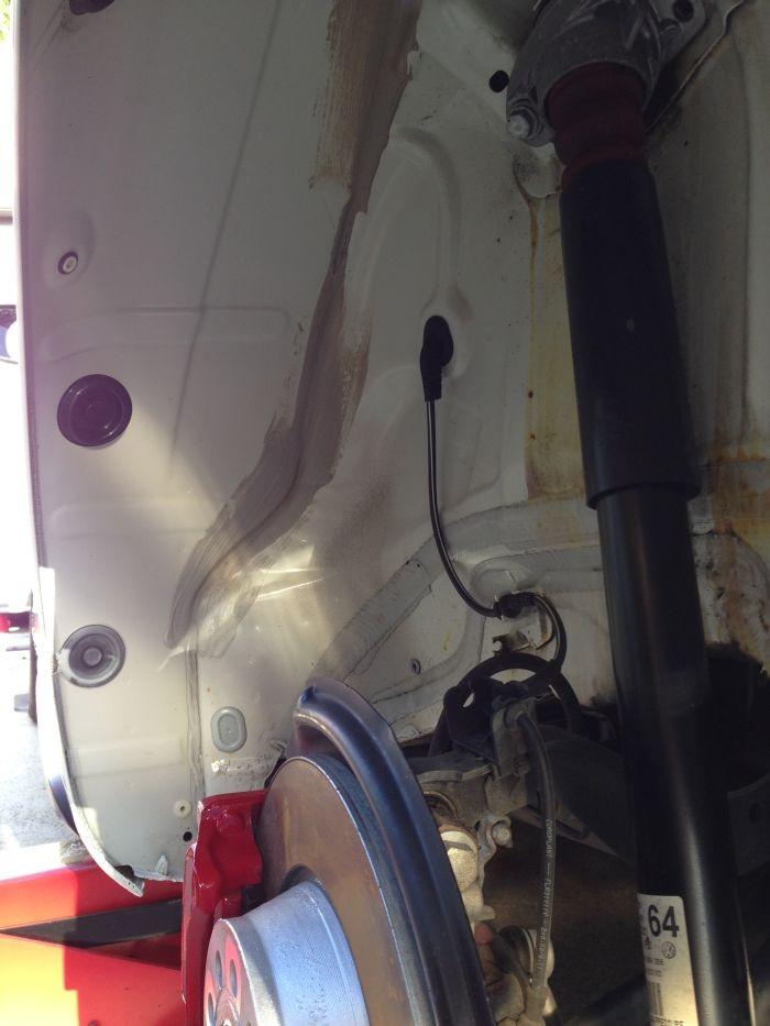

    Painted brake hubs and cleaning all the inner guards/suspension parts (removed lining to access):

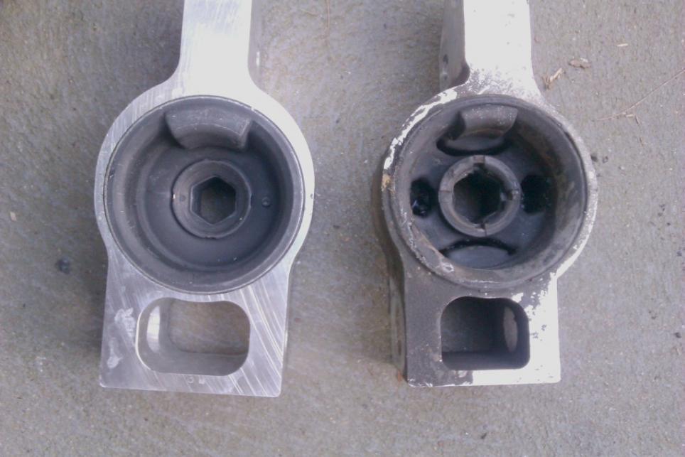

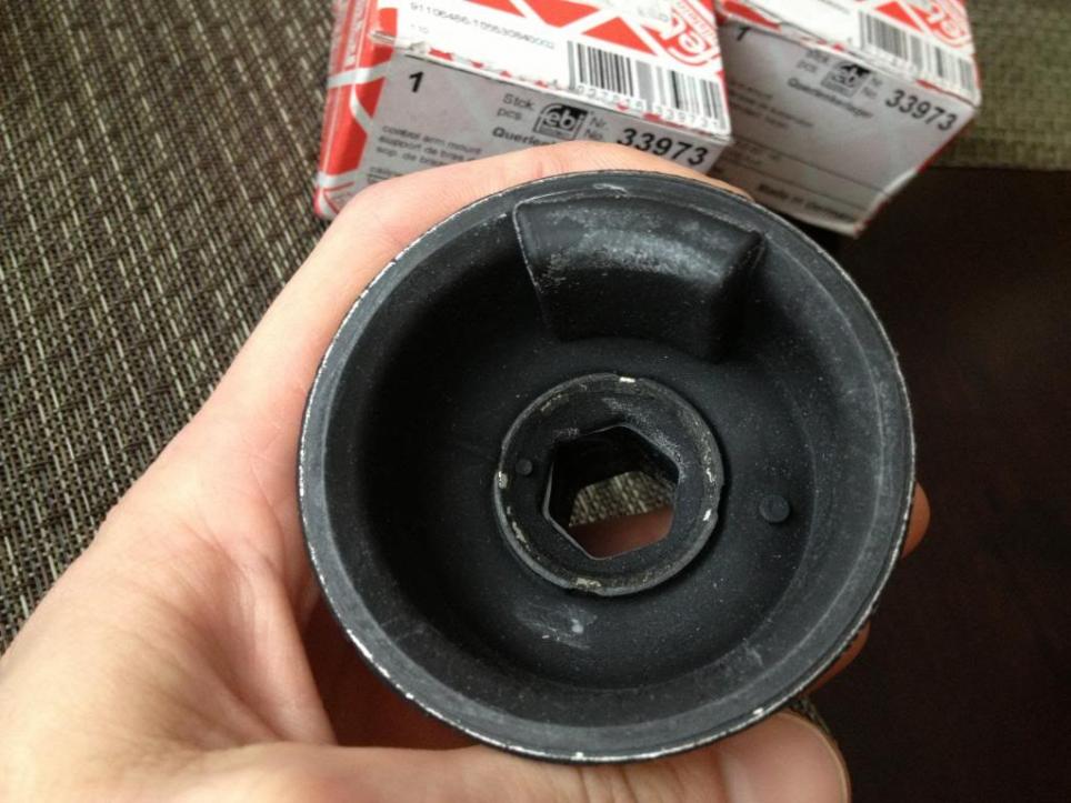

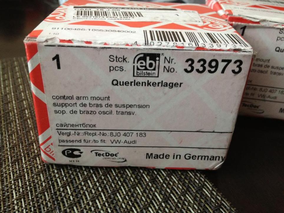

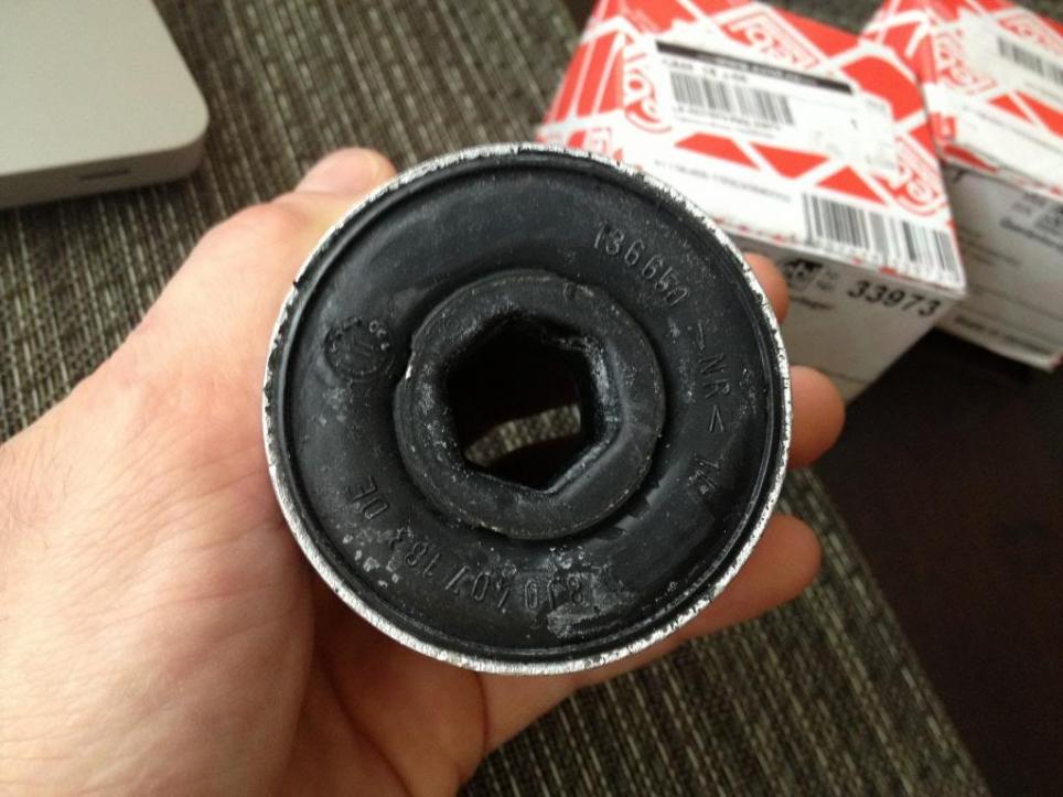

              LCA bushes from an Audi TT have been ordered. These are a cost effective alternative to a traditional WALK - although the OEM bushings do not offer caster adjustment. You press the old crappy bushes out and then press in the new ones. This was quite a popular upgrade until the ALK kits from Whiteline and Superpro made a name for themselves. This alternative is about 1/5th of the price of a ALK kit, so worth trying.
              These will firm up the steering feedback, reduce flex in the bushing by quite alot, and should help with "wheel hop".
              Cost under $50 delivered from the UK.

                  As with most panel air filters - not much if any difference to be felt or heard. But the stock filter was dirty and due for renewal anyway - so the $45 USD it cost (along with other things from ECS) wasn't a big cost. The OEM paper air filters are about $25 from ECS anyway. I can wash and reuse the AFE filter, so it will be cheaper in the long run. I made some "mods" to the stock airbox to increase induction noise which helped a bit, although its still quiet compared to my R.
                  I also have an intake to suit the Mk6 GTi at home (left over bits from all my other intakes ive had on the R), so ill try that out over the weekend too. Ive got a 3" dia silicone connector, a carbon fiber tube in 3" dia thats angled, and a pod air filter in 3" dia. So they will all fit together. Interested to see how that sounds.

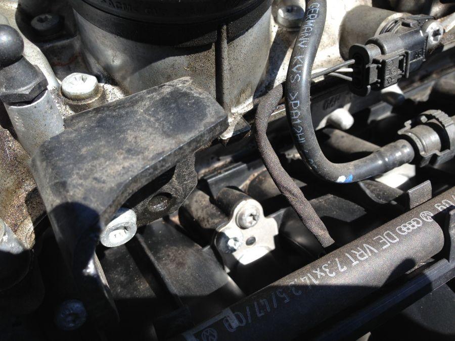

                        Fitted the wastegate rattle clip to the little K03 turbo’s wastegate arm. Those with the 2.0TSI engine will be aware of the horrible rattling (sounds like the engine is pinging) sound that these engines make on heavy throttle between about 2.500-4,000rpm. Well the sound is the wastegate rod rattling around. The clip fixes that problem.
