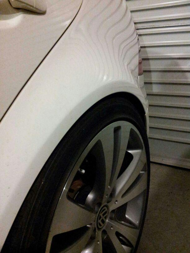

Yeah man yes to both will be good to catch up, I have only taken out the lower locking collars in the rear and evened out the front and hardened everything up still have some rubbing with big dips but its pretty good.
sounds good if been meaning to take my locking collars out in the rear except i think it will look funny cause the tire will be completely tucked and will scrub non stop. i defs wanna lower my car a little for the weekend tho i need to get my act together and buy smaller rims .

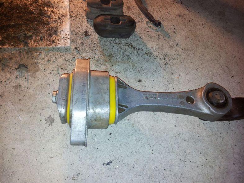

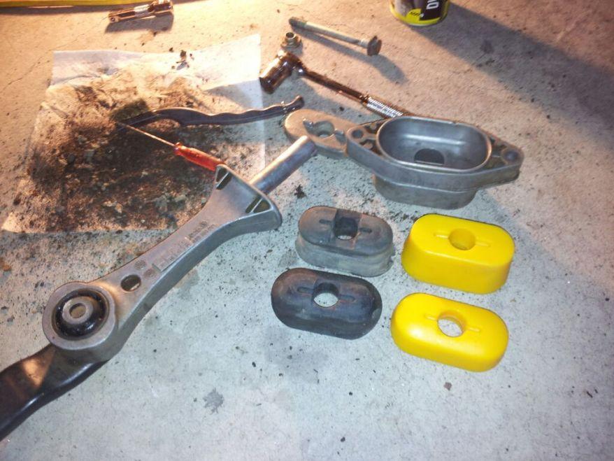

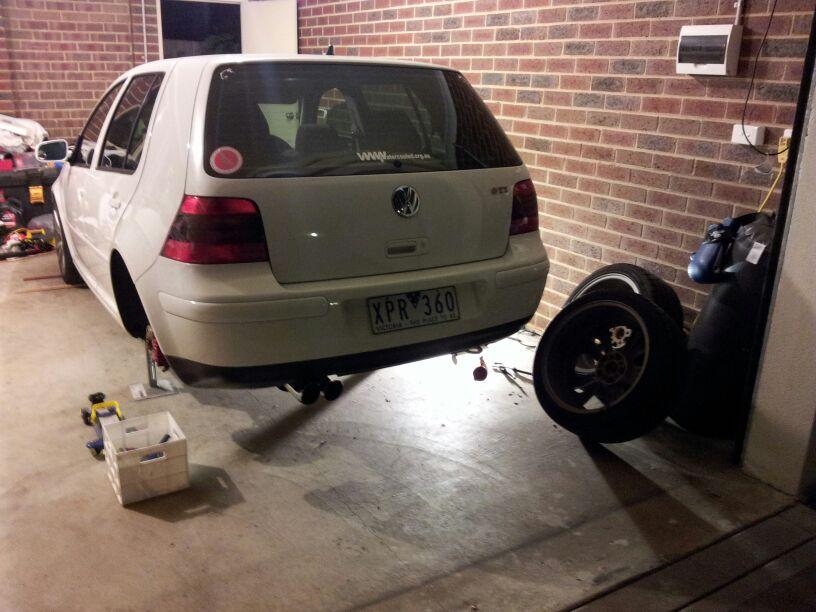

When I took it for a drive it felt like my teeth were falling out, swapped out both the larger and smaller mounts with the stock ones still really bad, also the exhaust tips have moved under the valance, the old mounts must of sagged heaps.
just spoke to Dean from Volkwerke and he noted that if I had a custom exhaust that with the new mount it maybe hitting the chassis somewhere and causing the vibration, so going to install the old mounts if the vibration is gone ill book it into the exhaust shop and fit the new mounts before I go in and have them readjust the pipes to stop it banging, I hope.
any other ideas guys.
