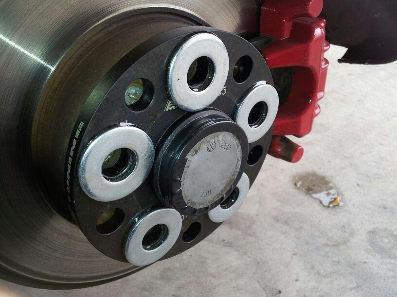

                      Got the spacers fitted better today, had a problem with a slight gap between the spacer and the wheel, Ryan said it was the same for his car.
                      I fixed it with some washers that I got that matched the gap and epoxyed them to the spacer so I could get the bolts through them, worked great, no wobble and its all nice and tight.

                        Here's a pic of the spacer and washers

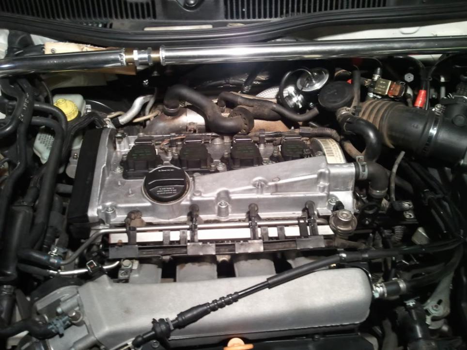

                          Wanted to clean up the engine bay some more so gave what I had sprayed another coat and added in the airbox while I have the pod in.
                          This is the first coat on the airbox.
                              That can't be safe..
                              R36 Twin Turbo Golf 650hp 0-100 3.1sec 11.106@125mph.
                              • #75
                                You're right. That is an absolute disaster waiting to happen. The wheel mounting surface must be dead flat to ensure consistent torque of the wheel bolts. Standard washers will deviate in diameter by up to 1mm and this will only be made worse by using varying amounts of epoxy to secure them.
                                There is very real potential for the bolts to work their way loose with a setup like this!! Scary
