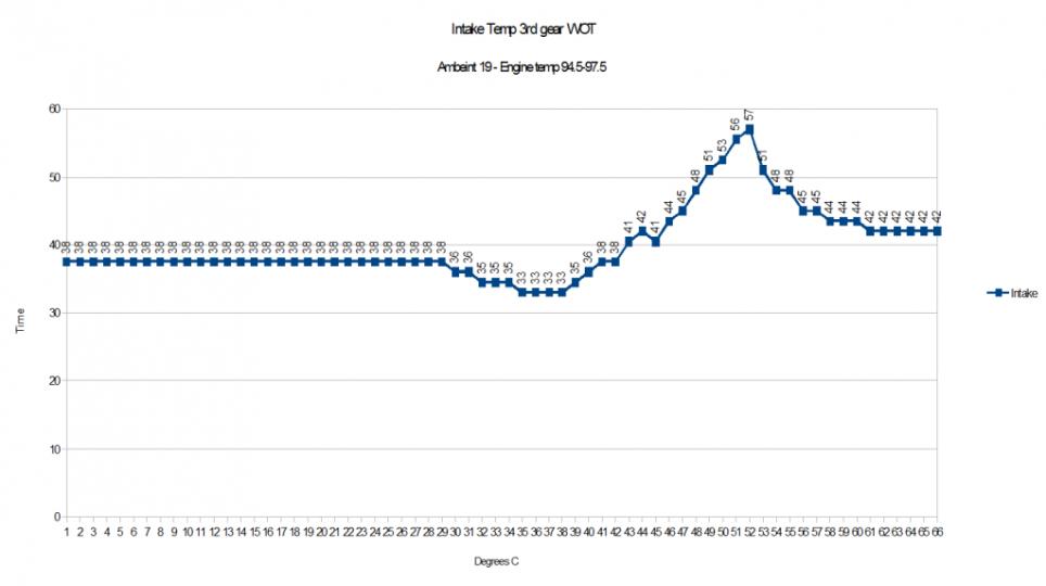

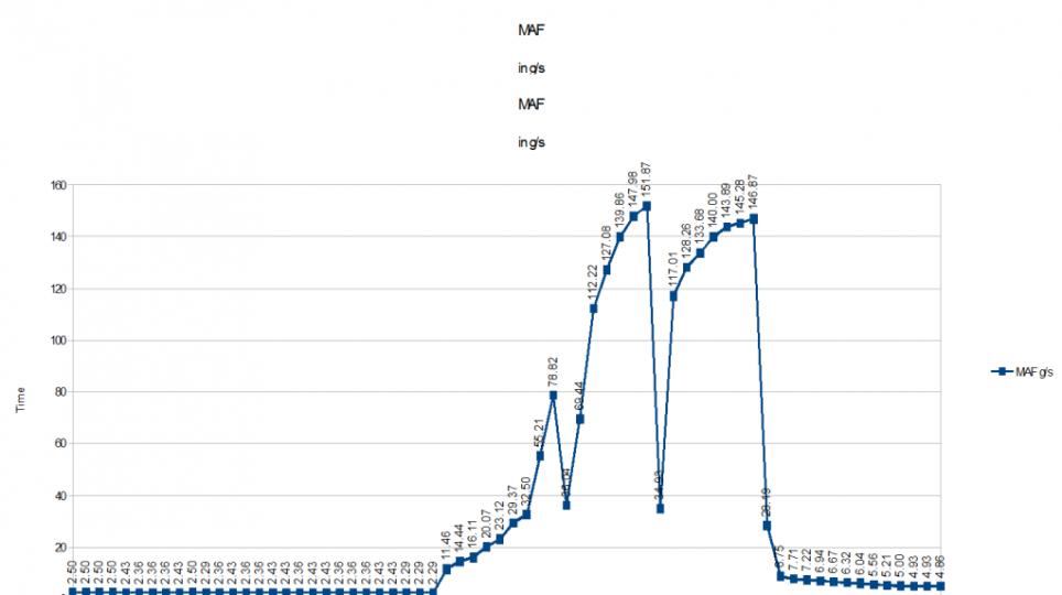

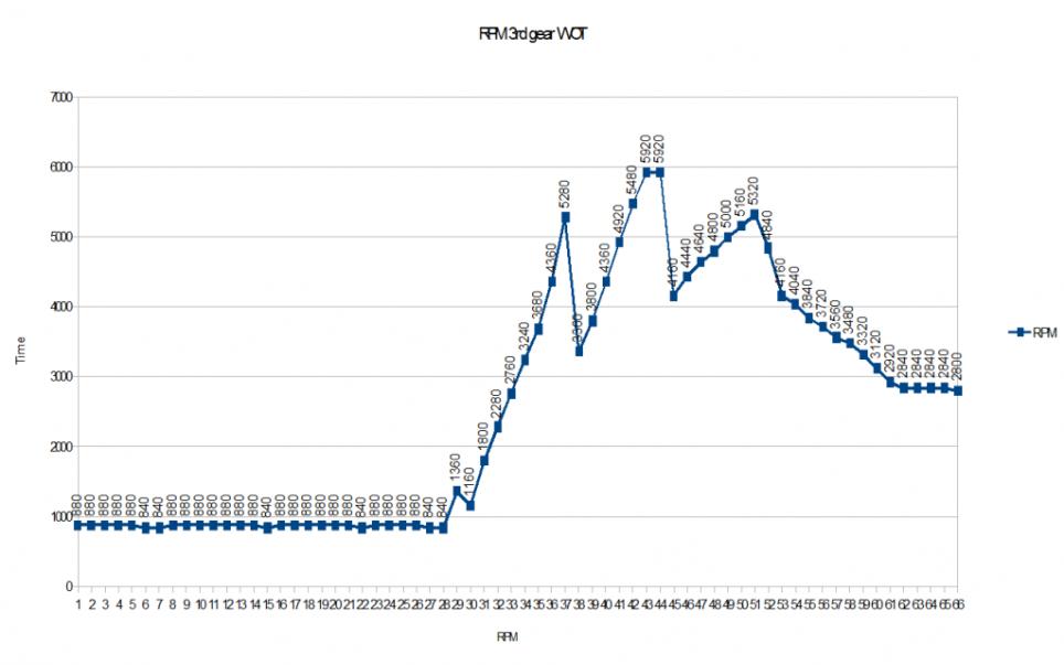

        Well I've done some logs of Intake temps, RPMs and MAF in g/s and converted to psi from bar using rpm and g/s.
        I'm running a giac chip and 3" downpipe with a pod.
        Test conditions:
        19c ambient temp
        From standstill 1st to third gear pull
        3rd gear WOT up a hill throttle off at crest of hill.
        Need some help I should be getting more than 9psi or am I missing something or have problems somewhere, I'm not throwing codes but I am running rich.
        What block would I look at to work this out.
        RPM
        G/S
        PSI
        Intake
        Any help would be great

            • i did some logs a while back and found the calc for psi from maf/rpm reading is way off checking against my boost gauge
              going by your maf reading 151g/s you should be higher than 9psi

                    • Originally posted by theOctopus View Post
                      Yeah my gauge shows 16-17 while the max the calculated values state is around 9. Keen to get the conversion values right or at least close to what the gauge displays.
                      Does that gauge sit at zero with the engine off? What does it indicate with the N75 disconnected? Has anyone else driven your car and said, hmmm it's really slow?
                      I'd say 150g/s is close to 190hp at the crank. Not that far out.......
