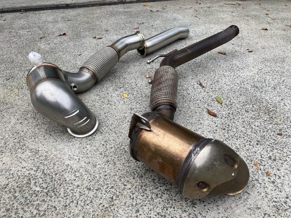

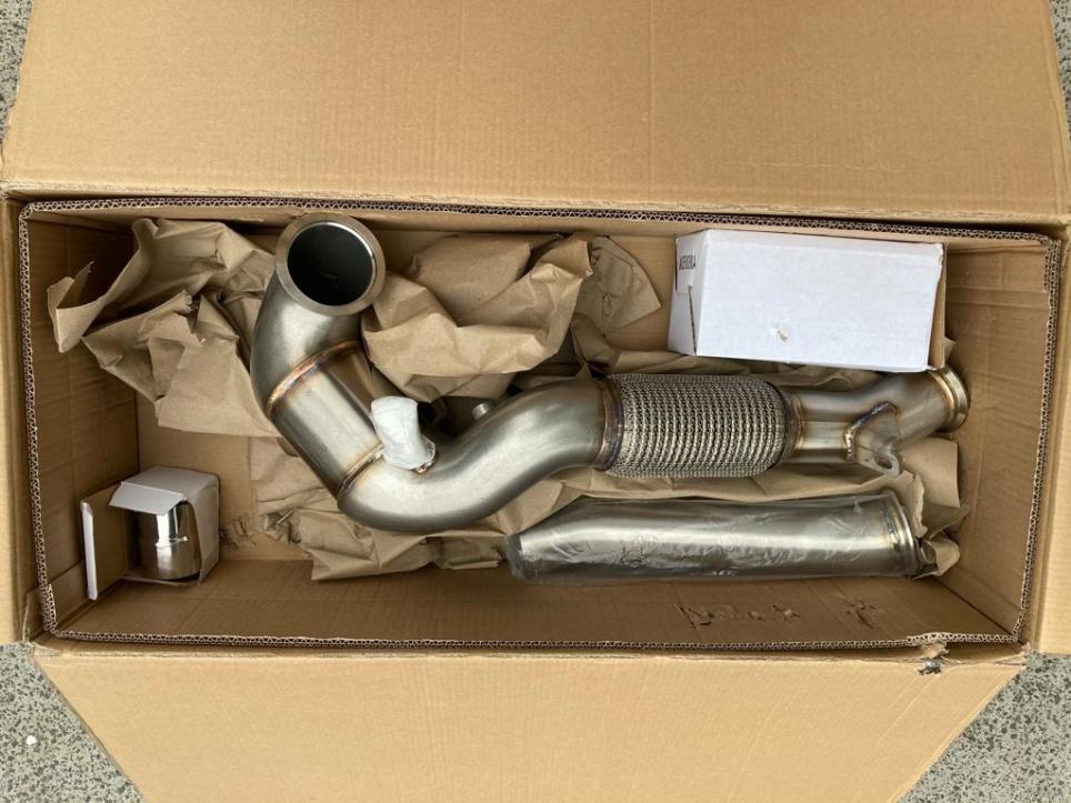

Im in the Mayfield area. Apart from my IE downpipe which I fitted yesterday (prick of a job....thanks to the Haldex diff on the GTI PP) my exhaust is stock otherwise. I did have a res delete but removed it yesterday after hearing the sound of the res delete and new downpipe.
Installed my IE downpipe on Saturday afternoon. Id be lying if I didnt say it was a prick of a job and more difficult than I was anticipating.....all thanks to the Haldex diff fitted to the GTI PP which is RIGHT where you remove the old downpipe, and RIGHT where you try to feed the new downpipe in. Not helped of course by the fact that the car was on jackstands in my garage rather than up high on a nice hoist.
To anyone with a PP, I would recommend a different style downpipe such as the Scorpion or CTS because they are nowhere near as bulky as the IE downpipe.

Hey mate. Sounds like there are a couple of GTI PP's running around Newcastle then. The CTS downpipe should be easier to install than my IE downpipe as its less bulky due to the catalytic converter being further down the pipe. If you are doing the install yourself you will see what I mean about the PP's diff being right in the way.

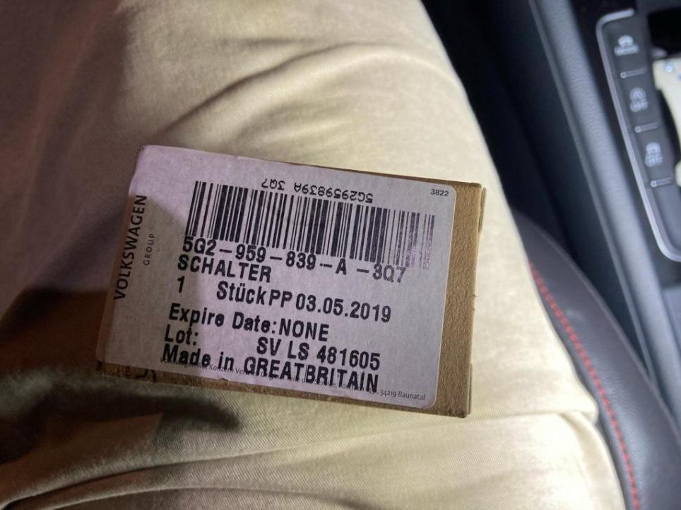

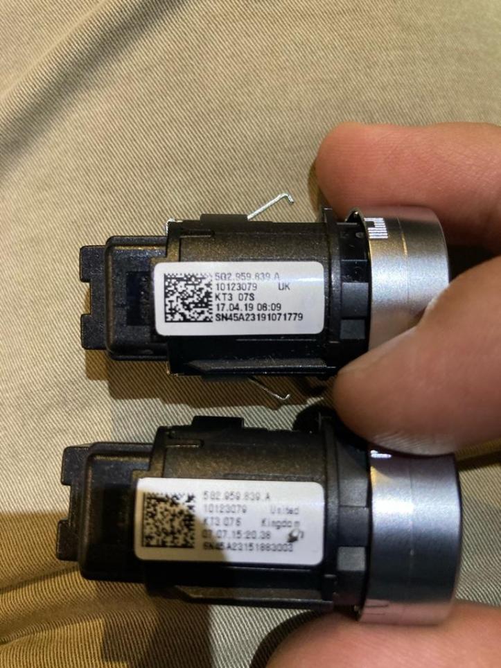

Just fitted a brand new start/stop button last night as the original one was starting to play up meaning you would sometimes have to push it several times to turn the car on or off.
Traction....so 1st gear you just dont go full throttle. 2nd gear it scampers for grip but mostly hooks up, but sometimes you need to back off for a split second and then feed the power back on. I have brand new tyres but they are not the best out there (Hankook Ventus S1 Evo 3) so with better tyres it would no doubt hook up better.
Interesting comment on the stop/start button, I had mine replaced under warranty a few years back as it was sometimes taking 5 minutes to start the car. ...and now its starting to get a bit iffy again. Is it easy to replace yourself ?...part from VW I assume.Originally posted by Lucas_R View PostGear selector is fine, just the little strip of leather on top is showing some wear. Will replace this sometime soon as i have been looking at options.

Yes its pretty straightforward to install. Pull up the shifter surround trim, unplug the cable from the bottom of the start/stop button, push the button up to remove it (takes some force) and pop the new button in.Originally posted by jdw View PostInteresting comment on the stop/start button, I had mine replaced under warranty a few years back as it was sometimes taking 5 minutes to start the car. ...and now its starting to get a bit iffy again. Is it easy to replace yourself ?...part from VW I assume.
I bought my button from a place in Hong Kong called SparePal. They specialise in parts for Euro cars. It was about $160AUD incl international shipping and took about 10 days to get here (most of that time sitting in Sydney customs). Its a genuine VW part and made in England of all places. The local price for the button was nearly $400 which is ridiculous.
If you go Googling you need to make sure its the correct button for right hand drive cars.
My original button had a date stamp of 2015 on it so its pretty likely to be the original one fitted to the car.
VAG SWITCH 5G2-959-839A 3Q7

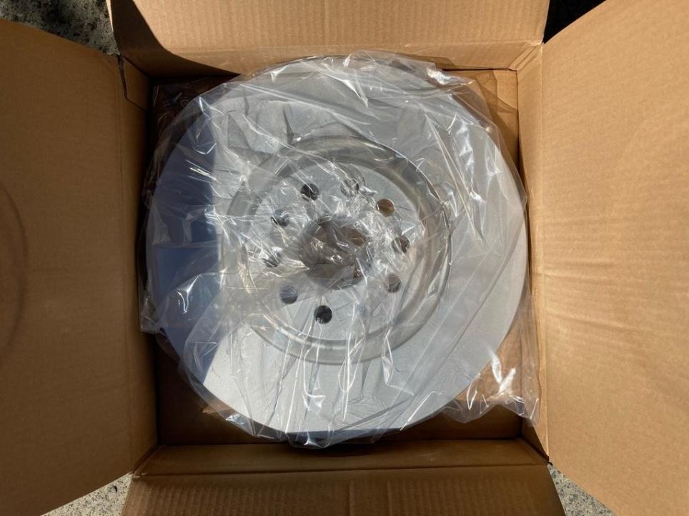

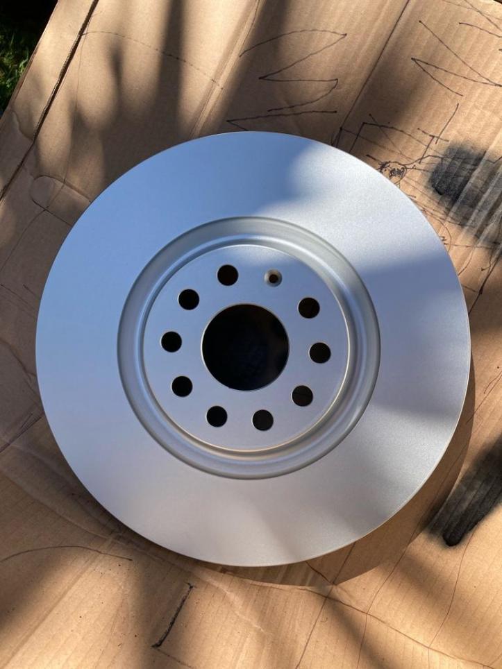

Also fitted the new Bosch front disks on the weekend. Still going through the process of rubbing the paint off the disk faces. Very happy with these so far, quality looks good and they were cheap. The old disks were well and truly rusted onto the hubs and took some not so gentle persuasion with a hammer to remove, before I used a wire wheel on my drill to clean up the hubs and put some anti seize.
Brake disk part numbers (for GTI PP/Golf R):
BD1566 fronts (340mm diameter)
BD1166 rears (310mm diameter)
Will fit the rears in the next week or two when the mood strikes me.
