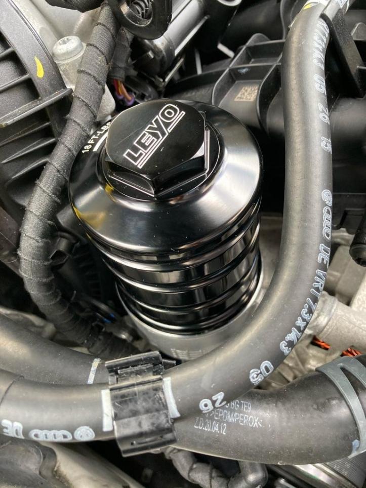

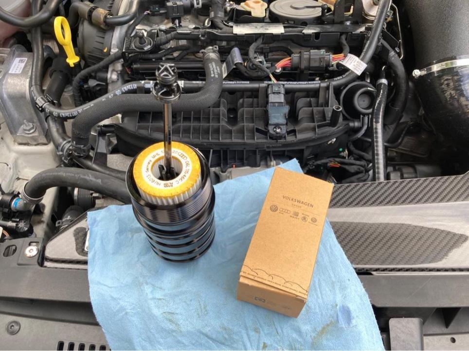

      My first task when buying a 2nd hand car is always a good service and check over of everything. The oil was still quite clean but you never know what oil was used (previous owner was a mechanic at a Newcastle based business called Nova Innovations - but you still never know). So I gave it an oil flush, and then replaced the oil (Penrite Enviro+ VW504/507 approved) and OEM filter as well as an oil flush. New OEM sump plug. Any no leaks or damage underneath to report which is always good.
      Also threw on a Leyo alloy oil filter housing the replace the crappy plastic OEM one.

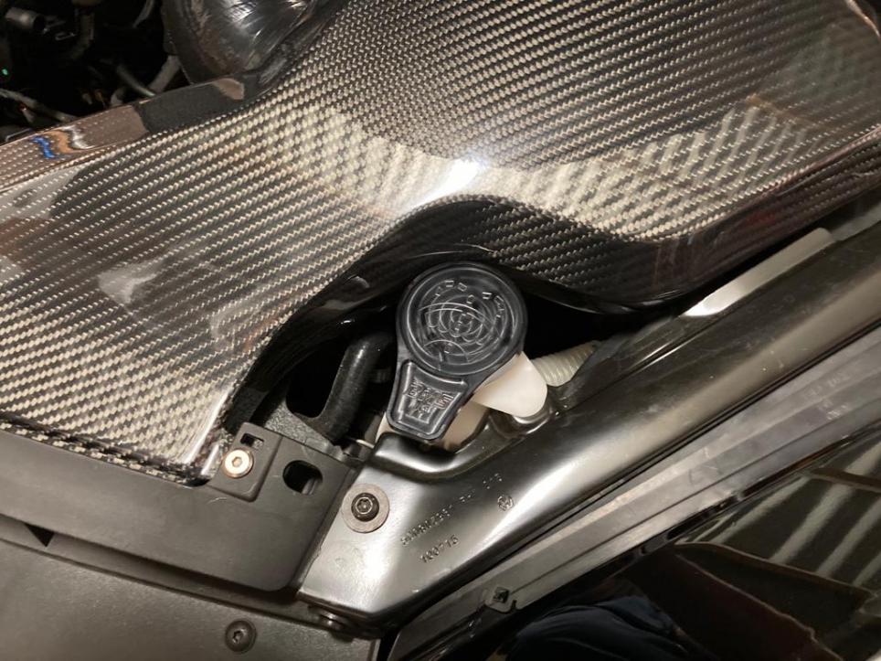

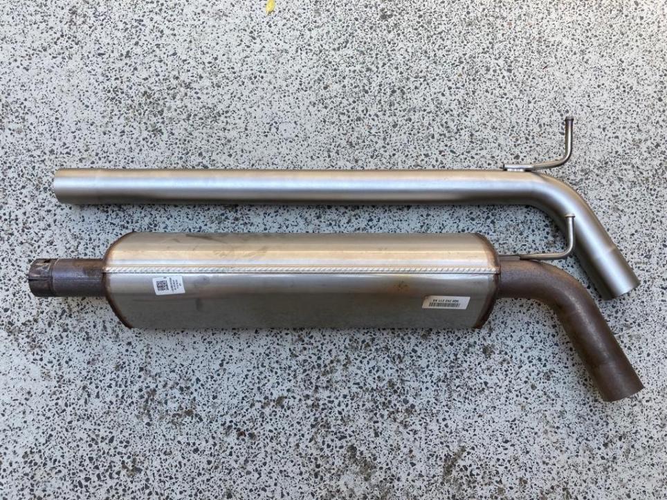

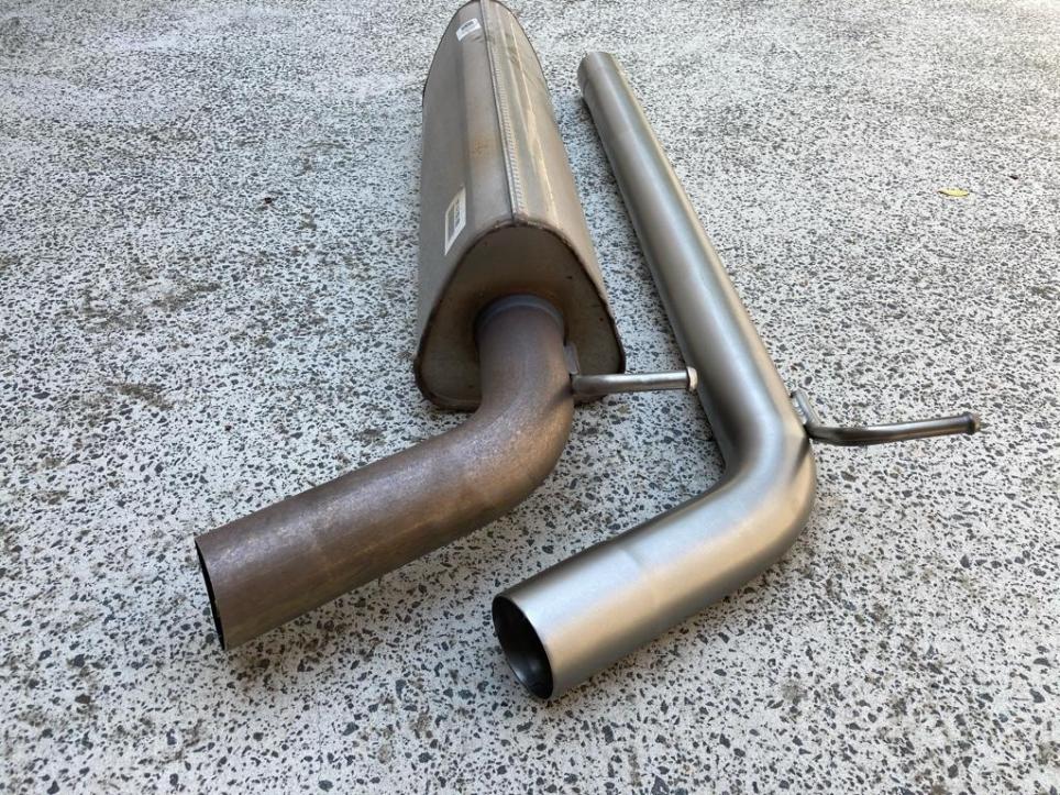

            Last weekend I fitted my 034Motorsports “Res-X” resonator delete which had turned up a few days earlier. Yet another very nice quality part from 034Motorsports.
            Damn the original resonator is massive and the GTI just sounded so lame with the stock exhaust.

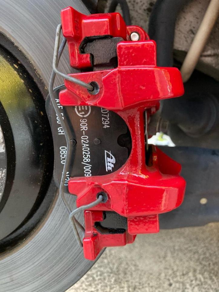

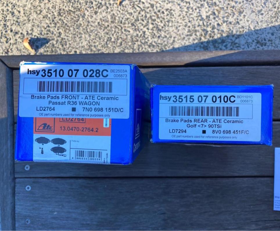

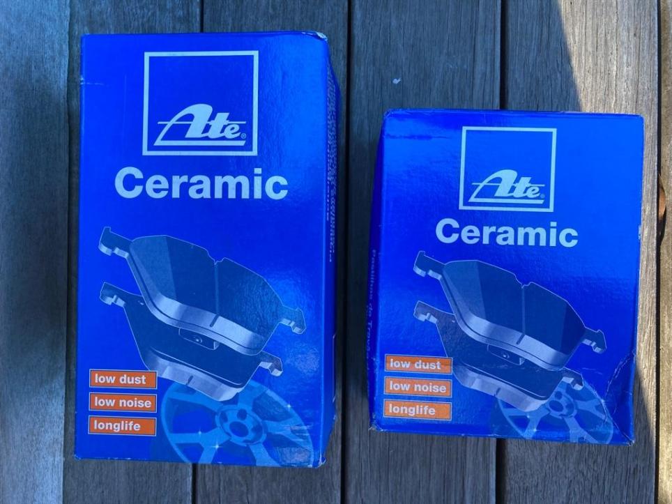

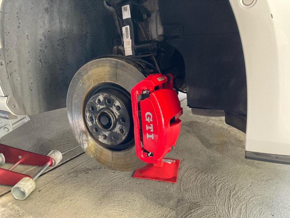

              Received my new ATE Ceramic brake pads this morning, so after work I set about installing what I could before it got too dark.
              The GTI Performance runs the larger disks and caliper (same as the Golf R) so I ordered the part numbers for a Golf R.
              Only got the rear pads done today, but will continue on with the fronts tomorrow.
              Also detailed the brake hubs as they looked like garbage. Used a wire brush attachment on my drill to remove the rust then painted with some satin black caliper paint. Not perfect but they look much better now. I’ll get new brake disks before too long anyway as these are pretty worn.
              B9 Audi SQ5
                My Mk7 GTI PP....turns out I cant resist the VAG.

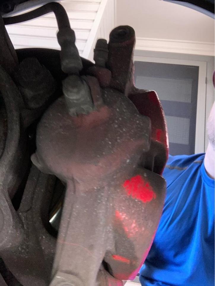

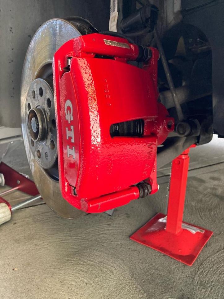

                Did the front brake pads this morning and gave the calipers a good detail as they were pretty grotty.
                Before vs after.
                Also painted the hubs.

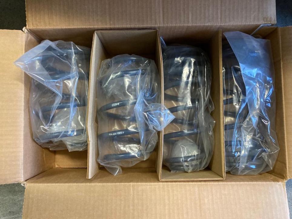

                  Got some more goodies on the way.
                  - 034Motorsports lowering springs
                  - 034Motorsports new street density strut tops and strut bearings (to be replaced while changing the springs)

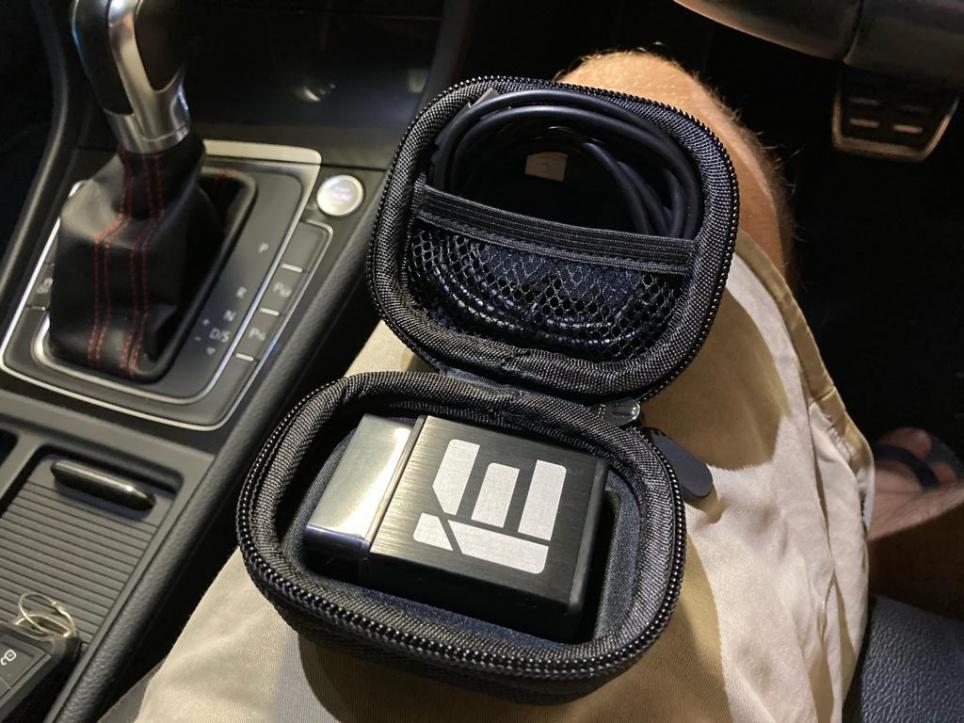

                      Unfortunately my Integrated Engineering stage 1 tune will have to wait a few days as my OBD dongle was faulty upon arrival and couldn’t communicate with my ECU....replacement unit is on the way.
