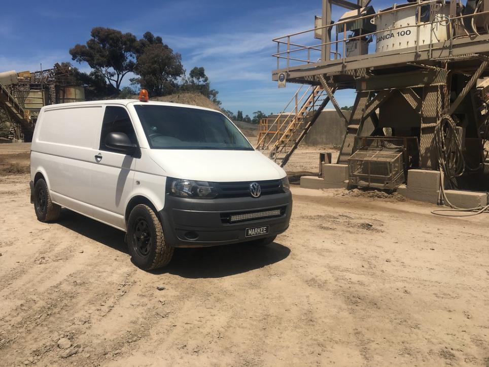

          Piece of cake one wire to ground on the body second wire to a 30amp relay this in turn is connected to the high beam wire which triggers the relay and doesn't cause any issues with the factory wiring . Place the relay close to the battery as you can tap into the headlight wire right next to the battery .
            My LED light bar came with a wiring loom that uses an adapter plug for the back of the hi-beam globe inc a relay and isolating switch for inside the cabin. Meaning I can switch it on or off only when the hi-beams are being used.

            Made my own mounting brackets and didn't have to remove the bumper bar.
            2012 T5 LWB 4Motion LIFTED

                  Same as what Sunny said above. It's fantastic for lighting up the road to the side, even better when there is surrounding tree coverage. It just gives a whole lot more reaction time because you see suicidal skippy sooner.
                  Going back to regular beam when you get an approaching car is actually scary how little you can see!

                        I suspect that Markee and I are in the same boat in that we don't need something that will light up for miles along a dead straight road, what I want is to be able to see kangaroos coming in the dark so I don't hit them. They will usually come from the side so if the light throw is good for 100m all around instead of 6km straight ahead then this suits my purposes greatly.
                        It looks like the mounting brackets are alloy not plastic, and the wiring harness seems to be quite plug and play hopefully with T6 Multivan.
