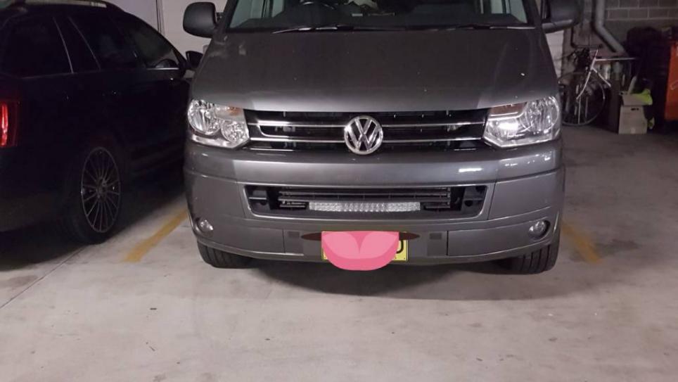

    Need a side mount not under mount. I have to take the bumper off to adjust.
    Sent from my SM-G930F using Tapatalk
    • #32
      Don't you know its rude to stick your tongue out at people .

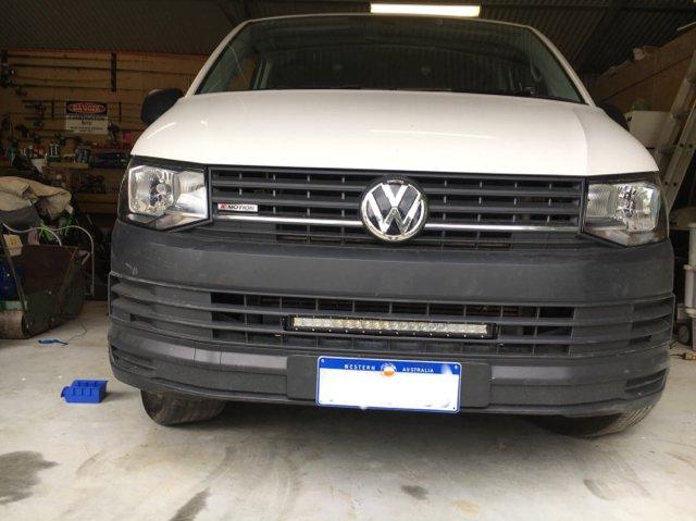

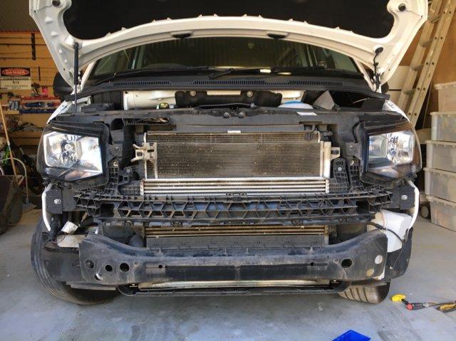

          So finally got around to fitting my light bar on the weekend. Very happy with the finished product. Only took a few hours to complete. Removed the bumper (about 30-40 mins) , fit the light bar and connect wiring, (30 mins max.), run the switch wire into the cabin and into the dash (2 hrs. This was the worst part). Refit the bumper & cut out opening for light bar (30 mins). A lot easier than I expected. (Was going to put up some pics, but haven’t worked out how to post pictures yet. Still new to this). The wiring harness that I bought with the light bar makes it so much easier. Wouldn’t do it any other way. Gonna make a huge difference for our trip across the nullarbor this weekend.

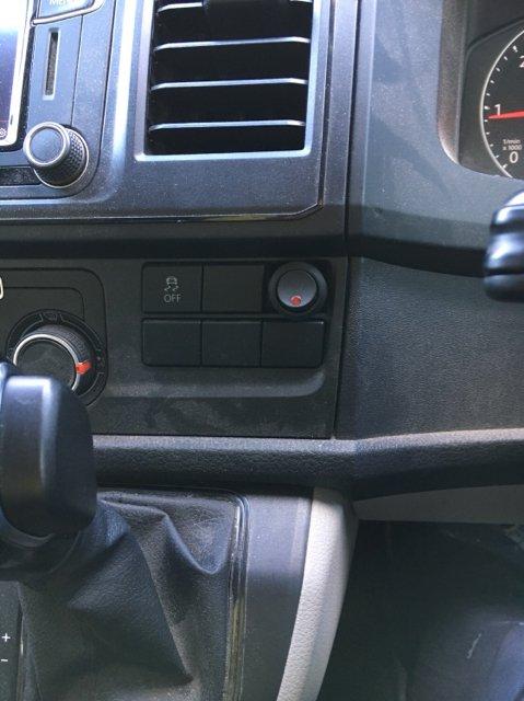

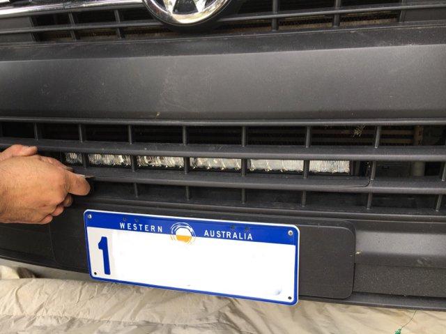

            So hopefully this works. First pic obviously with bumper removed.
            Cutting out opening for the light bar, and then the finished product.
            Just need to see if I can find a different switch that will fit into one of the dummy covers in the dash.
