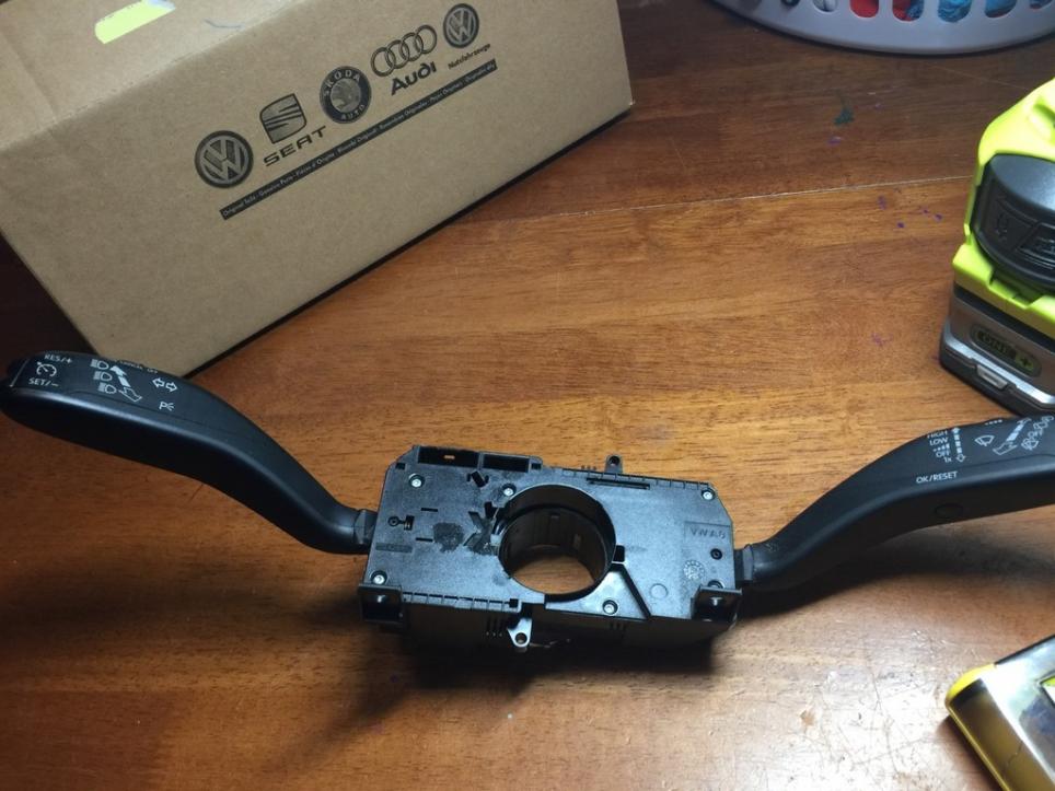

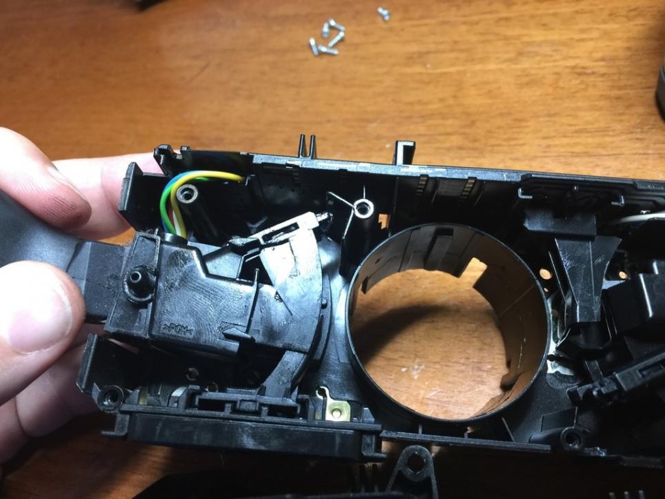

          So things didn't go quite as planned. By Thursday things had deteriorated to a point where my Wife (given it's her car and all) couldn't live with it anymore since it would set off the indicator over every bump... so ordering from overseas and playing with it was less of an option.
          Volkwerke came to the rescue and ordered one locally for me and fit it... The new one is beautiful.
          Out of interest, I asked if I could keep the busted up part so I could pull it apart for your viewing pleasure (and because I was interested in what actually broke).
          So this is the part made out of unicorn tears:

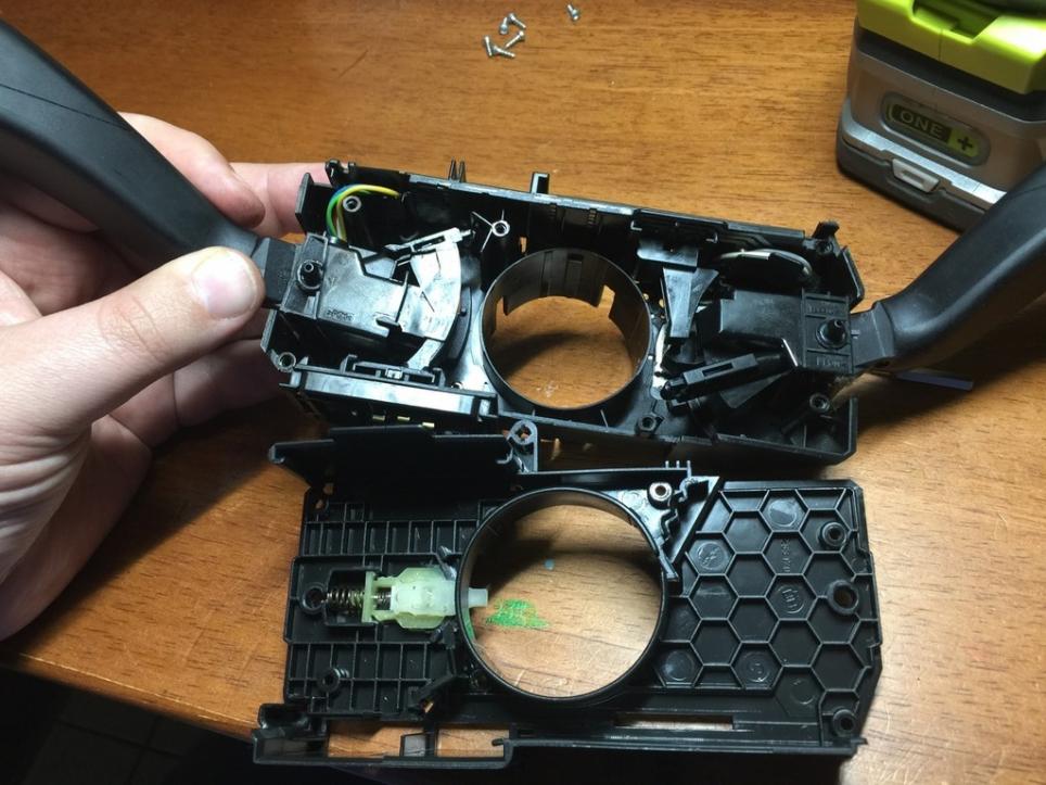

          And the inside:

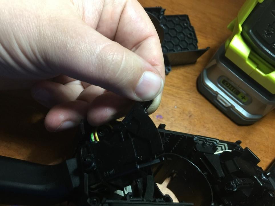

          Getting closer:
          At this point I still can't find any loose plastic bits or clearly cracked pieces...

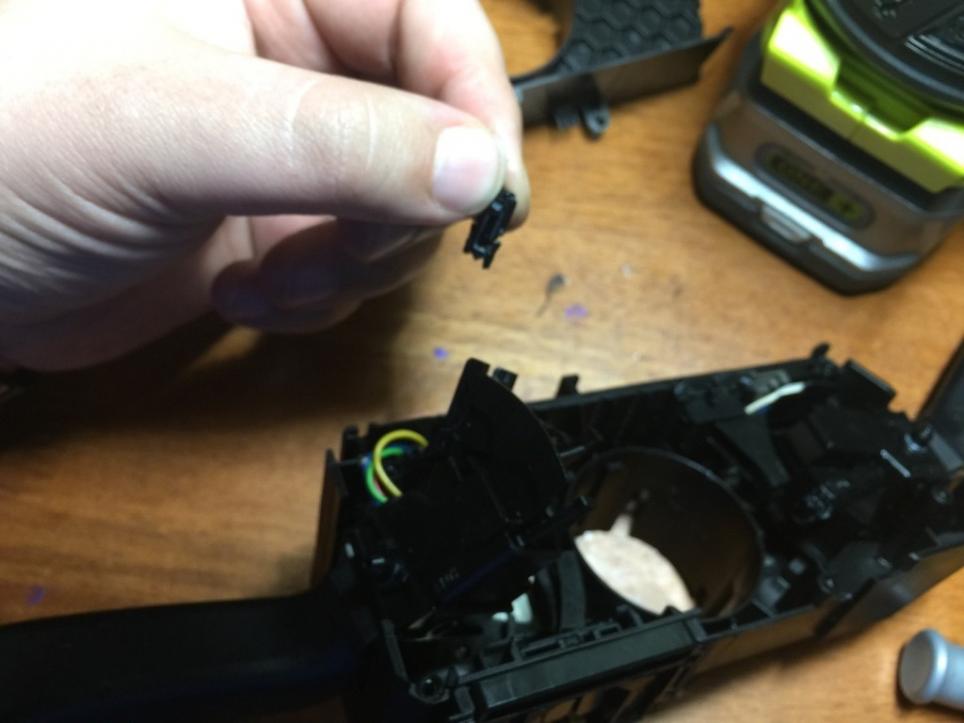

          So as I dug further in I find this little slider piece:

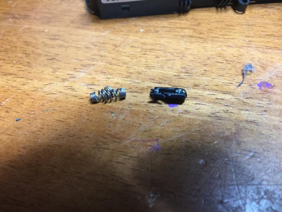

          A little clip later and it slides out neatly, all in one piece...

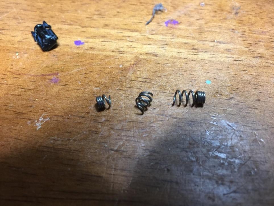

          The spring behind it a little less so:
          So after all the expense and trouble, this isn't a worn piece of plastic giving up the ghost and snapping off, a busted contact or anything more than a simple failed spring.
          For what I can only assume would be a few cents (even a couple of bucks for me to buy a single one from a local ... ummm... spring guy??) it would be possible to fix this unit.
          I've kept the busted spring with a view to hunt up a new one (not that I need it right now). If I ever do that I'll post back with results. If nothing else I hope I save someone else the cost of a pretty expensive part for the want of a single spring!
