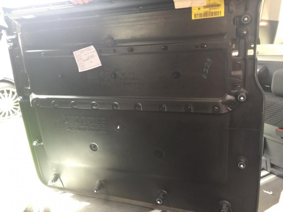

        So it's possible to remove the inner door trim with the door in place, which was a bonus. It's also worth noting there are three pieces. The upper bit around the top of the windows frame and the bit on the inside door handle do not need to be removed, it's possible to remove only the lower piece which is held in place by a range of clips. Around the outside edge are larger plastic ones, there are three smaller little ones in the centre and some steel ones across the top. I managed to get them out and back in and only cracked two (although they still seem functional)... so WIN!
        I was able to pull the panel off using nothing but my hands *relatively* easily. You need to be careful near the door handle for the locking rod for the door lock button as it does foul if you haven't removed the whole handle trim piece.

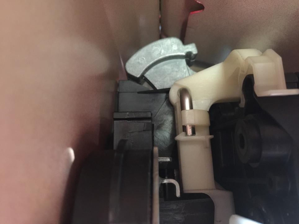

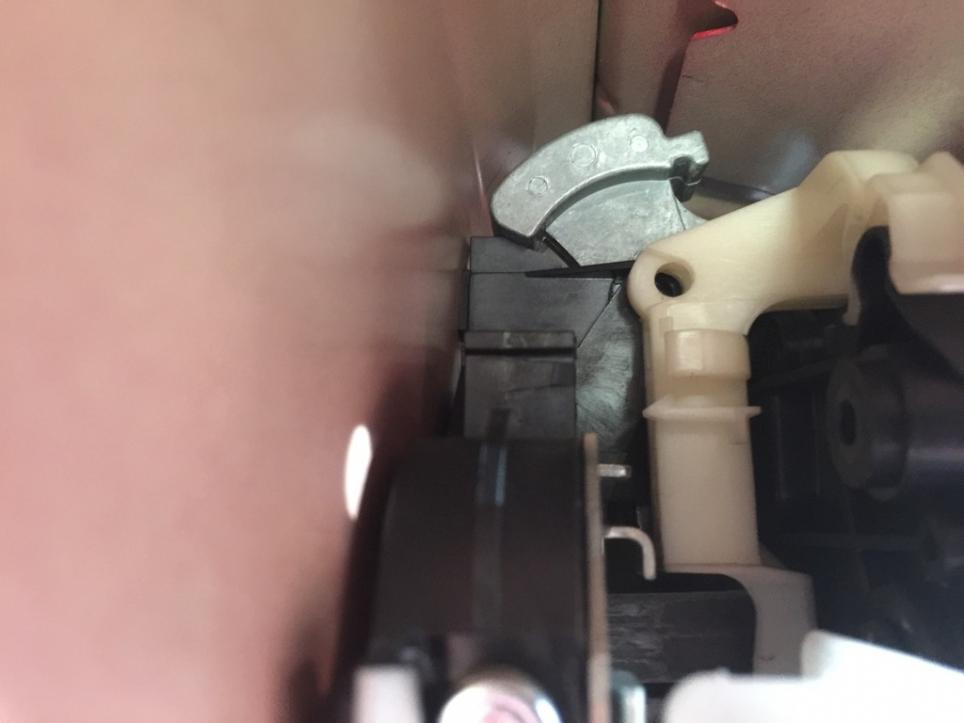

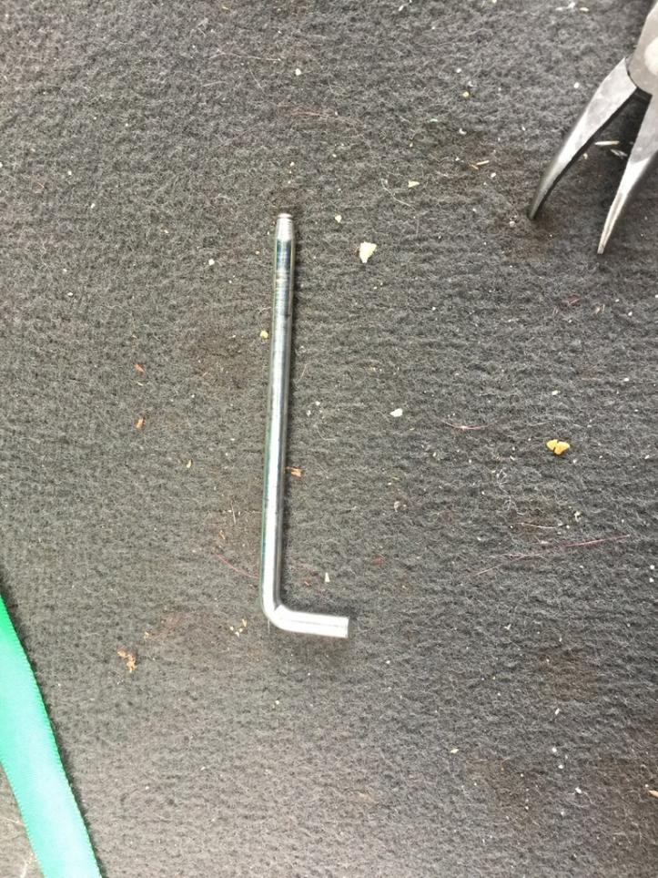

        So... the problem. I found this little sucker inside the door panel... and I'm glad I saw it before I tried pulling more things out too because if I missed it this would have gotten a WHOLE lot more complicated!
        Inside the door, there is the mechanism that does all the things. The counterweight (??) you can see here is attached to the outer door handle with that pin I found earlier, you can clearly see it missing.
        Here with the pin back in place, you can see it clipped back into its plastic retaining clip. I'm not sure how exactly it managed to come out of that then manage to work its way loose, but 6.5 years and 150,000km of pulling and rattling got there eventually it seems.
