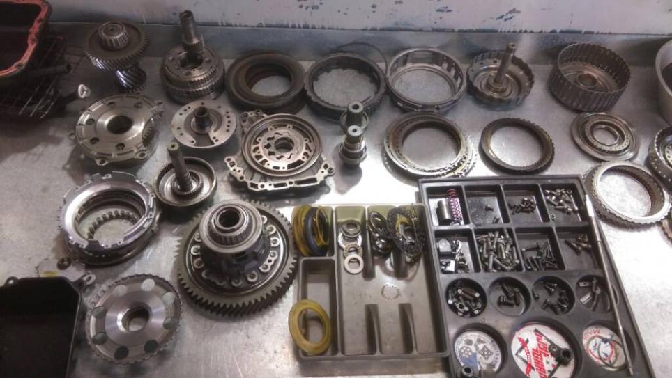

    Here is a Valvebody from a O9K Transmission out of a T5 Van, we can repair these units and we also rebuild the Solenoids, replacing the bushes inside the solenoid it self.

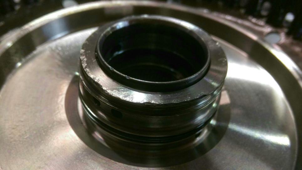

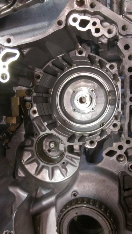

                  Here are some pics of a T 5 that I am doing, u can see the K 2 clutch sleeve (steel) in the bottom of the case, this is a common failure, they spin and block the oil feed hole, loss of 4/5/6 gear, or shift complaints
                  The other issues these units have is the K1 clutch circlip groove wears allowing excessive clearance in piston movement
