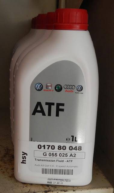

One of the VW specifications for the 6-speed transverse Aisin (Japanese) transmission is G-055-025-A2.
To date, I haven't seen an ATF approval list from VW like there is for engine oils. (Does it even exist? Probably not.)
If your transmission needs a G-055-025-A2 spec fluid, then you can try Mobil ATF 3309.
The internet says that JWS 3309, and Toyota T-IV can be considered interchangeable, and since Aisin has been an automotive supplier to Toyota since forever, it wouldn't at all surprise me if you could use Toyota T-IV fluid (save $$$).

I'm sure if you call VW they would tell you what oil to use in AT. The transmissions and diff fluids aren't easy to check by the driver/owner, so they probably don't make such list a public affair.
I would probably stick with the well known oil company, when selecting ATF for VW car, even though it is the AISIN trany. Last time I looked at that specs oil, I was quoted $50/L in 1L bottles.
Now obviously, VW don't actually make the fluid themselves. It would be supplied and bought from a lubricant manufacturer.
All I'm saying is, I would try and get the fluid direct from the lubricant manufacturer, rather than pay whatever VW are charging for it. $50/L!? Bloody hell...
I'm guessing a 20L container of Mobil ATF 3309 would cost way less than that...

Very good information Diesl_vert! And yes, VW quoted me $50 per Litre for the OEM ATF and said I required 8L's. $400 for oil? You gotta be kidding me! Hence the reason to use Penrite DX-VI as recommended by another T5 owner.
