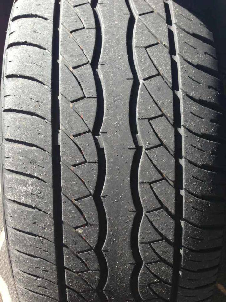

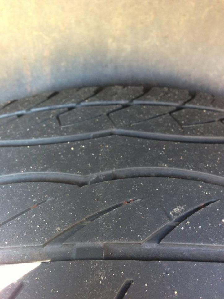

                              • T5 Tyres 17" what is available in OZ
                                Question on pressure vs wear.
                                On my placard it shows:
                                light load front 44psi rear 38psi
                                Heavy load front 49psi rear 49psi
                                I've done just under 15k on my maxxis MA P1 and I've been running pretty spot for that time on 44psi front and rear. My van is never fully loaded probably less than 300kg in there including me.
                                I have noticed that my rear tyres are wearing faster than the front.
                                Checking the wear indicators:
                                Front drivers side - outside 3mm inside 4mm
                                Front passenger - outside 3mm inside 3mm
                                Rear drivers side - outside 1.5mm inside 3mm
                                Rear passenger side - outside 0.5mm inside 1.5mm
                                Would this be down to pressure, alignment, driving style or a combination of all?
                                Pressure too low/high?
                                Just finding it unusual to lose rubber from rear tyres faster than front on a FWD.
                                rear drivers side
                                front drivers side
                                Sent from my iPhone using Tapatalk 2
