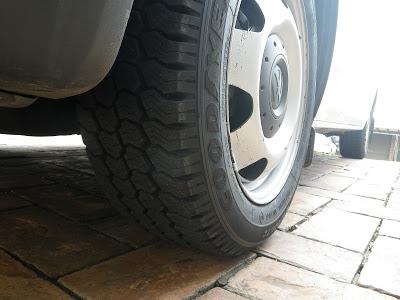

      Just an update; finally yesterday, I've put GoodYear Cargo Vector 215/60R/17c on my T5. The first impressions aren't good. The tyres are noisy and hard, I had to drop the pressure down to 58PSI (from 65PSI) to get it to some acceptable level. The rolling noise is something to consider, if you thinking about buying them, and unless they last 70k-80k km, they're not worth of the comfort that is lost. I should've go for the Maxxis MP1 instead.

        No offense but they look a little bit like light truck tyre with that pattern and the apparent sharp edge at the top corner of the tread its probably why they are going to last that long on a van but the trade off will be ride and noise issues . I know this will bring howls of protest but I still think 65psi is way to high I have never heard of pressures that high on these vans , our tyres on both out T5,s are Federal Formoza FD2 235/ZR 17 103W XL max load 875kg max pressure 50 psi . The tyre fitters told us max pressure between 45 and 48 psi was the best they would recommend on average we get around 40-60 thousand kays from each set at $200 a corner . They give excellent ride with extremly quiet on road noise and seem very good in the rain and the dry . Everyone has their own thoughts on tyre pressures and tyre types so this is just my own opinion .

          Yes, they're commercial tyres, so no offence taken. The area where I drive has lot of roundabouts and the roads in Adelaide are getting worst every day. You'd be lucky to find 1 km of the road with a good road surface, which is probably wearing the tyres a bit faster.
          As far as for the higher inflating pressure, the 70PSI is for the max. load for that tyre. With the previous tyres, I've always ended up with the worn out tyre shoulders despite I've the tyre pressure monitoring fitted and always kept the pressures to 51PSI as per the tyre placard. I've realised that even 58PSI is maybe too high.
