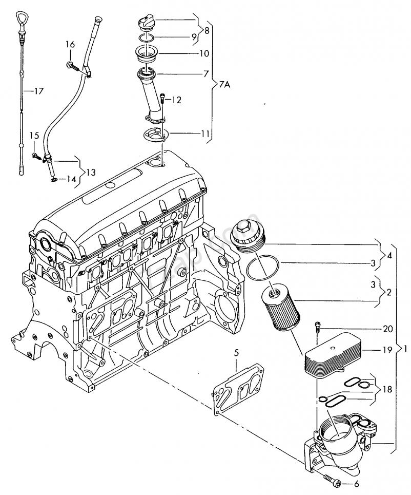

    I have the front off vehicle & im down to removing the oil filter housing which hosts the oil cooler. I cant see a way to take the oil cooler off without the filter as there are bolts inside under a manifold.
    However, even the ol filter housing has 2 bolts that appear unreachable , behind A/C mounts.

    Should be 4 or 5 bolts holding it to the engine block.

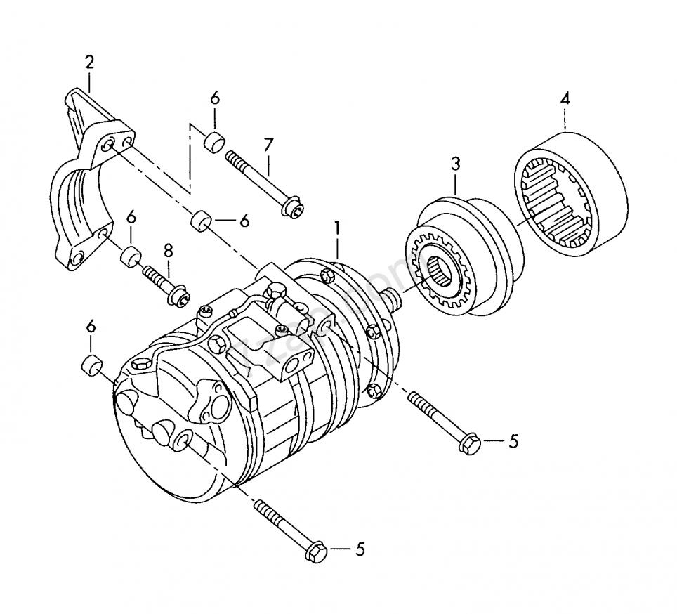

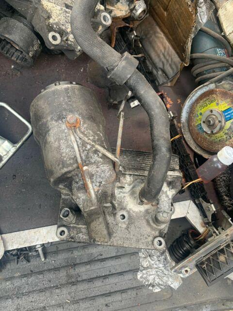

      Yeah I have aircon off & 3 bolts out. 2 lower ones are ungettable with standard tools. One towards middle of car is behind aircon mounting/moulding meaning hex goes in at around 25 degrees. One towards outside doesnt have enough space to put an allen key so will need to cut one down. Perhaps a ball Alan key works? Am I missing something?
        Hope the images help to understand what it looks like in pieces.

          Frkkk! Thats it. I thought (2) was part of the block. So 8 & 7 are still there blocking me from bottom right corner of oil housing.
            Thank you.
