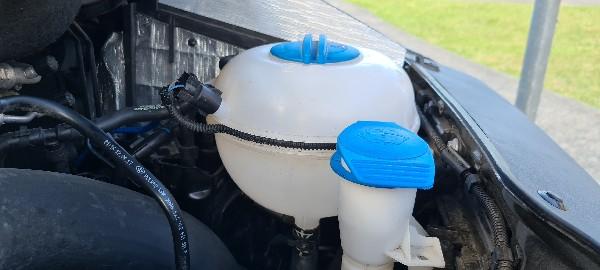

              2km after collecting my van i get a dash warning to check coolant. I pull over & pop the bonnet to find the coolant reservoir bone dry. 2km back to the workshop & they struggle to come up with a bull5hit reason why, mutter something about a radiator hose with a kink in it & tell me it will be ready in 5 minutes. 1 hour later i'm on my way again.
              Today, everything feels fine, fingers crossed there was actually water/coolant in my radiator. They better not email me with a request for a review...
                VW Australia emailed today with a request for a review! Haven't done it yet but will get around to it in a couple of days.
                After reading of Transporters recent issues with the Crafter, have decided to have my independent mechanic check things out & get their thoughts on the complete lack of coolant 2km after the warranty repair. Wonder if they can check engine oil for contamination? I don't think the coolant went into the engine, i do think they forgot to fill it...
                    To check the EGR cooler you need to remove the EGR pipe from cooler into intake manifold, easy enough to find. If any sign of pink fluid there (coolant), I suggest you take it back to them. Also easy enough is to have the engine oil analysed for contamination.
