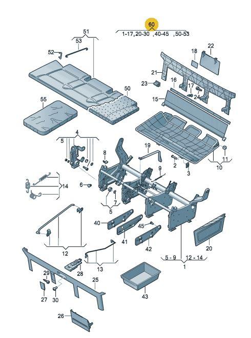

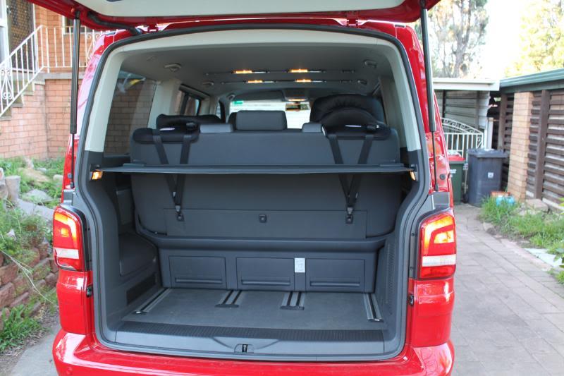

Just thinking out loud here, is there any way to retrofit the top seat components from a Multivan 3 seat bench (which has three anchor points integrated) onto the lower mounting parts from the Caravelle?

Interesting idea the main issue with that idea and this is without seeing one in the flesh is floor mounts . All loads for seats and seatbelts child anchors are tested on the actual place the seat is anchored to on the floor along with backrest as well , the Multi seat must be different to the Caravelle or are the seat numbers different ie 7 seat not 9 .
I added an image above from our van showing the mountings from the Multi. Yes it's a completely different floor mounting system, and I understand this would be in no way a tested configuration, but if the seat and backrest share a common bolt pattern to the Caravelle frame it might well be something that could be easily fit and engineered given it's a completely self-contained system based on the same chassis.Last edited by The_Hawk; 15-09-2019, 10:52 AM.

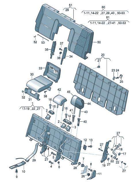

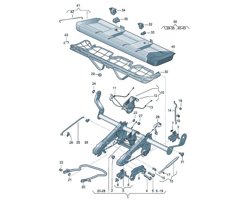

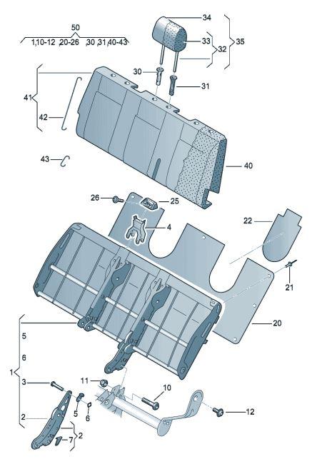

I've added the ETKA images where the connection between the base and the backrest look very very similar. While it might then require a retrim so it matches the rest of the vehicle, it does look like it might just be possible to fit at least the backrest if not all the parts.

Hi The_Hawk,
Thank you for the pictures. I believe the picture you provided from your van is from an early model T5. Is that correct? The later models T5's and all T6's have the anchor points in the top half of the seat backrest.
Do you have the ETKA pictures for the later models?
I actually started stripping the back rest trim to see if there are any similarities to the Multivan seat. I'll have a better look today.
