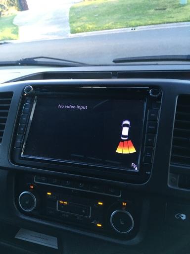

                      I hate to say it , but I want to replace my RNS510 with an Android for my T5. It has park assist. But does not support IPhone and no reverse camera.
                      From all the posts I have read it seems too much of a pain in the arse to try to get the 510 iPhone compatible and add reversing camera.
                      I have a Hizpo head unit in the Golf and it works ok.
                      The only thing I’m worried about is park assist , if this is purely a can bus function , and whether there are any android head units that will display the park assist interface. Also I have seen split screen for park assist / rearview on OEM ( or am I just imagining that)
                      A. Is it worth the money and the time to convert the RNS510 to iPhone and reverse camera? If so what do I need?
                      B. If not , is there an Android that will support park assist( girls maybe driving the car , so may need it)
                      C. I might just try my Hizpo golf head unit and see what happens
                      Any ideas would be much appreciated
                      NB I have not been able to update the maps on the Hizpo. And the Nav software has a glitch where the volume jumps every now and again when some announcements are made ( annoying, startling), that’s my only gripe about this unit.Click image for larger version

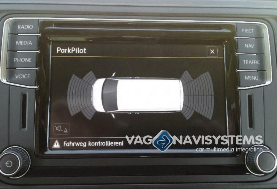

                        What do you mean by Park Assist? Do you mean the parking sensors with their pictures of which sensors are going off?
                        Our Multi has parking sensors and would have had the factory RCD310 which I didn't think had a display to show what the parking sensors were doing. You just got beeps from the front/rear speakers that got faster then a solid tone as you got closer to things.
                        In our case the dealer fitted a Pioneer AVIC system which had zero integration with anything so we have only ever known the beeping (and never pictures), but the AVIC did have a reversing camera installed so we have that.

                        On the head unit with split view on the RNS510, this is just a coding issue. You can make it show both the OPS and RVC at the same time with VCDS.

                          I will try the head unit from the VW (Hizpo). See how it works In the multi.

                            Yeah, I've never had that picture, only ever had beeps
                              OPS Works well . All functions same as in Golf. Just have to fit reverse camera. I might fit 2 with a video switch . One for normal reverse angle , and one near stop light for higher view.
