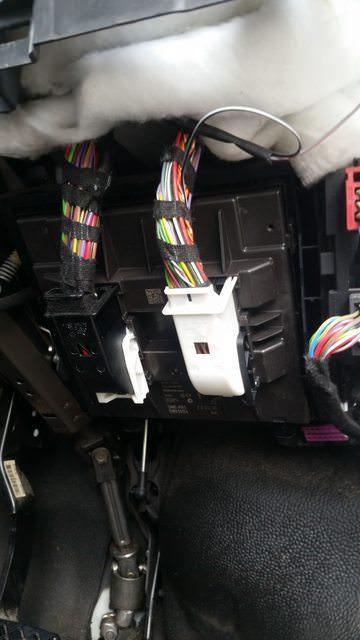

                    this shows the easy access to the wires to the BCM
                    the second wire taps into the light switch
                    russ

                      Gotta be careful of those unsolicited emails...
                      Making great progress there Russ!
                      Not so difficult when you have a bit of info to reference.
