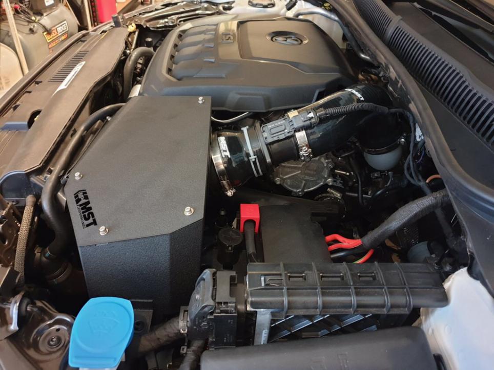

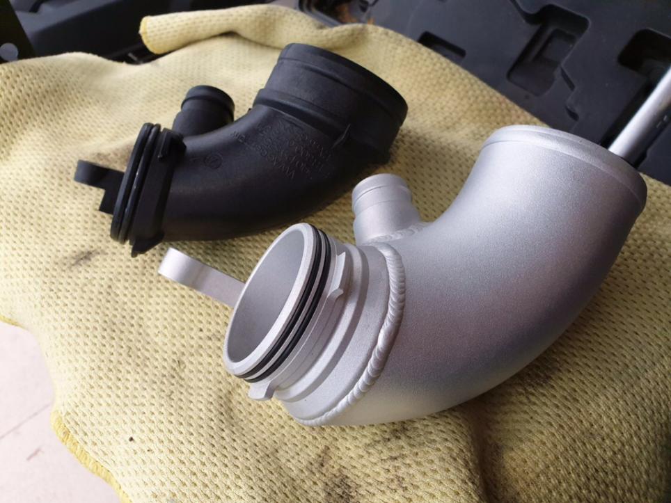

Well i can tell you it is a very nicely made airbox with good quality silicone pipes, and the airbox fits perfectly. The turbo muffler delete is also nicely made and fitted perfectly too.
You can choose to run the airbox with or without the lid if you want some extra noise, but without the lid it will let suck some hot air in.
There is definitely some nice induction and turbo noise with the new setup. I have a few pics i will upload shortly.
That’s great Lucas, thanks so much for sharing. Did the install require any cutting or drilling, or it was a straight bolt-in with the factory mounting points ?
2018 Polo GTI - CAI, TMD, ECU and DSG retune, and a bit of bling.
Everything bolts straight up to the factory mounting locations, no need to drill or cut anything.
