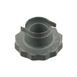

                      The hub nuts have ratcheting tabs that tear/bend off when you remove them. The nuts are only 50Nm + 1/4 turn I think so they need those tabs to be safe I think. Once they are fitted there isn't really any available thread that protrudes that you could get onto with a lock wire.

                        I'm not familiar with Polo hub nuts but the common design has an outer flange for punching into the drive shaft slot. So I usually reverse them from the side to side so the punching is in a different spot. They actually don't carry much load as all of the drive goes through the splines. The nuts really only carry the tension load from the drive shaft boots (hence the low tightening torque for their size). As long as they don't loosen, so the threads and locking need to be in good condition.
                        Are they this style?
                        If so don't worry about the tabs, just punch in the flange.

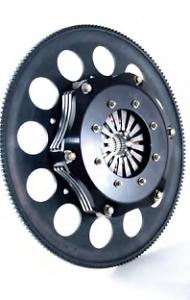

                            • The flywheels we use in the race cars are designed for 5.5" twin or triple plate clutches, totally unsuitable for a road car.

                              Sometimes the flywheel and pressure plate are only balanced together as one unit. So make sure that they were individually balanced. If not then you will need to get them balanced. Twice, once individually and then again checked as a unit.
                              RPM and centrifugal force are the big flywheel killers. That and loose flywheel bolts, double whammy. Loctite is your friend. If it's flat and doesn't have deep heat marks it should be fine. Spend some time with the straight edge.
