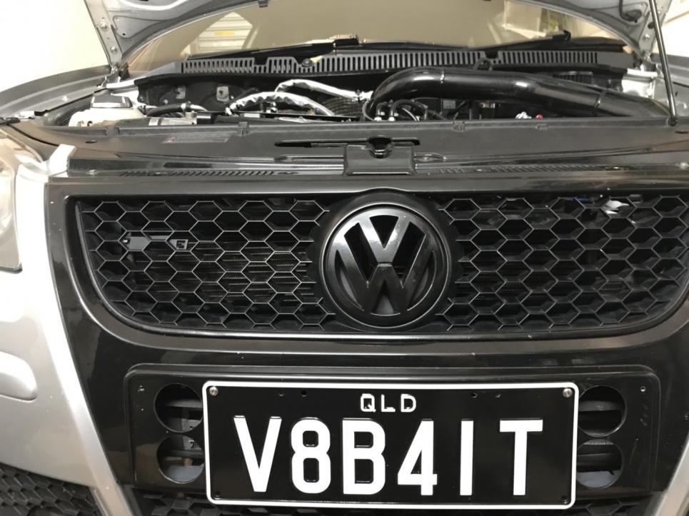

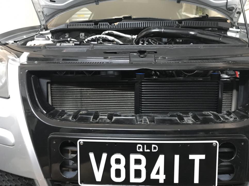

                              • Some laps at QR this morning testing out the new changes to the cooling systems. Had a blast
