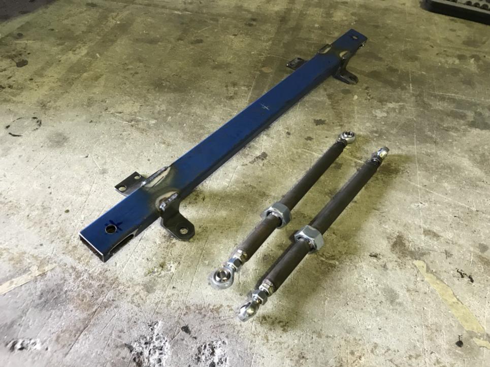

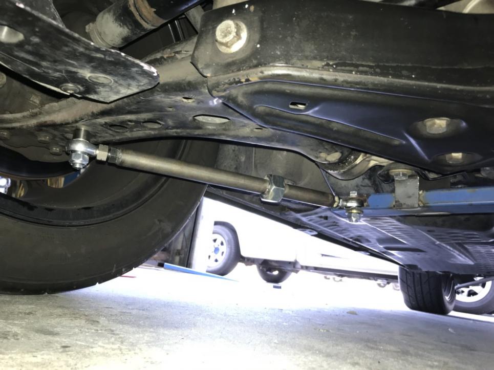

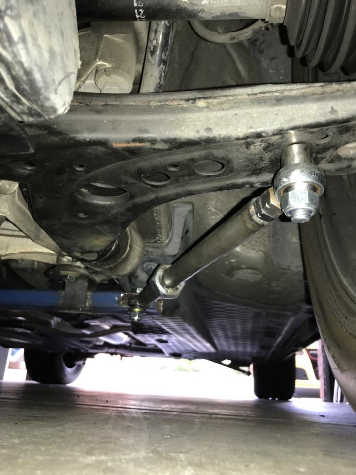

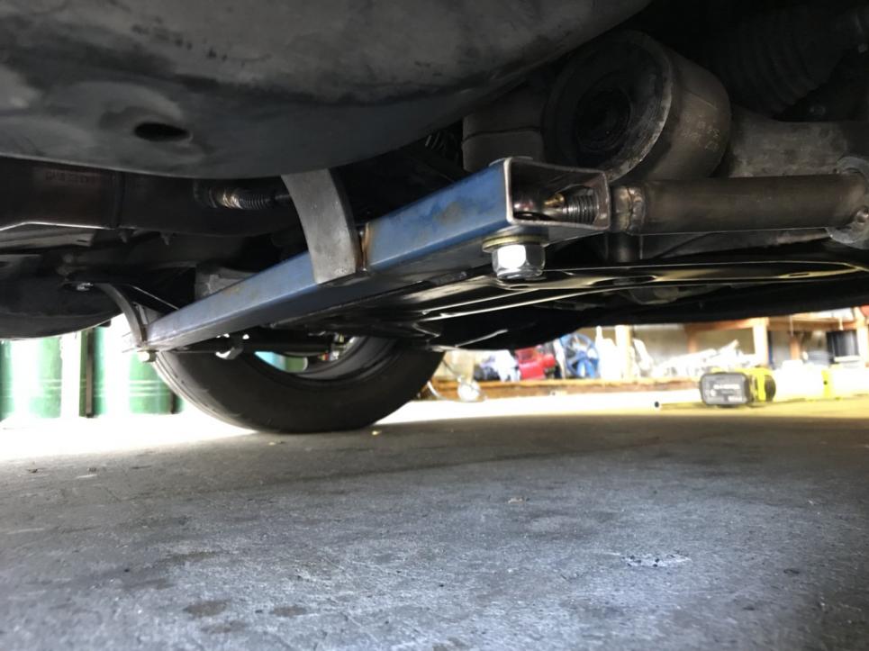

                          On top of the boost by gear I’m making some physical changes, such as traction bars which I made yesterday and today. They will come back out tomorrow for some paint as they are steel. Only done a handful of pulls before heading home but the improvement is significant and very noticeable in the way the car acts under hard acceleration. I’ll also be looking to stiffen the rear spring rate, most likely in the form of rubber spring helpers/spacers that some drag racers use as you can just put them in on the day of the track day then remove them afterwards so you aren’t compromising on a stiff ride around town.

                            • Those rods, they'd help prevent castor change I suppose. Do they help with axle tramp too, is that the aim?
                              • Yup that’s correct Sam. The idea is it stops the lower arms moving around and unloading under power. Helps stop Axel/wheel tramp as a side effect.
