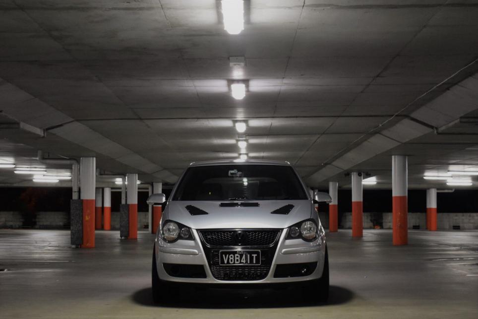

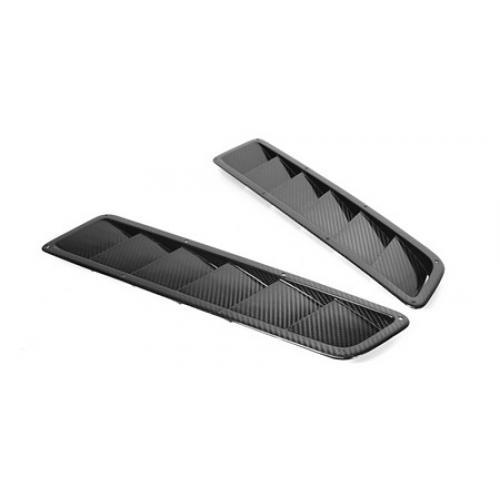

Too late now of course, but the usual convention is for the vents to be below the surface profile, to avoid creating turbulence.
The bonnet actually creates some down force, particularly the area in front of the windscreen. Turbulence from protruding vents would disrupt that.
Cheers
GaryGolf Mk7.5 R, Volvo S60 Polestar, Skyline R32GTST
Originally posted by Sydneykid View PostToo late now of course, but the usual convention is for the vents to be below the surface profile, to avoid creating turbulence. [img]
Cheers
Gary
Am I missing something in that thought process?Track Car: 06 Polo GTI Red Devil mkII
Daily: 2010 VW Jetta Highline
Originally posted by seangti View PostHi Gary, a lot of the timeattack cars run them above the bonnet, e.g. Under Suzuki's S15 and Nick Ashwin's Evo, etc, etc. All the leading cars engage aerodynamacists, seems to work for them. I don't disagree with an effect on turbulence, though perhaps that aids in heat extractions causing a low pressure behind vent lip therefore suck engine heat out.
This video shows a hood scoop on a Camaro actually letting the high pressure air from in front of the windscreen into the engine bay, not letting the hot air out. Yours is bit further forward so it would be a good test with some wool tufts at a track day to see what's actually going on. Plus it's a fun thing to play with, gets the spectators' interested.
We can see the 2 tufts on the scoop and the 2 on the bottom of the windscreen showing the airflow going into the scoop.
Cheers
GaryLast edited by Sydneykid; 13-02-2018, 01:00 PM.Golf Mk7.5 R, Volvo S60 Polestar, Skyline R32GTST

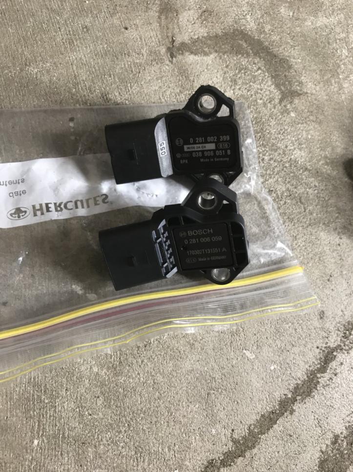

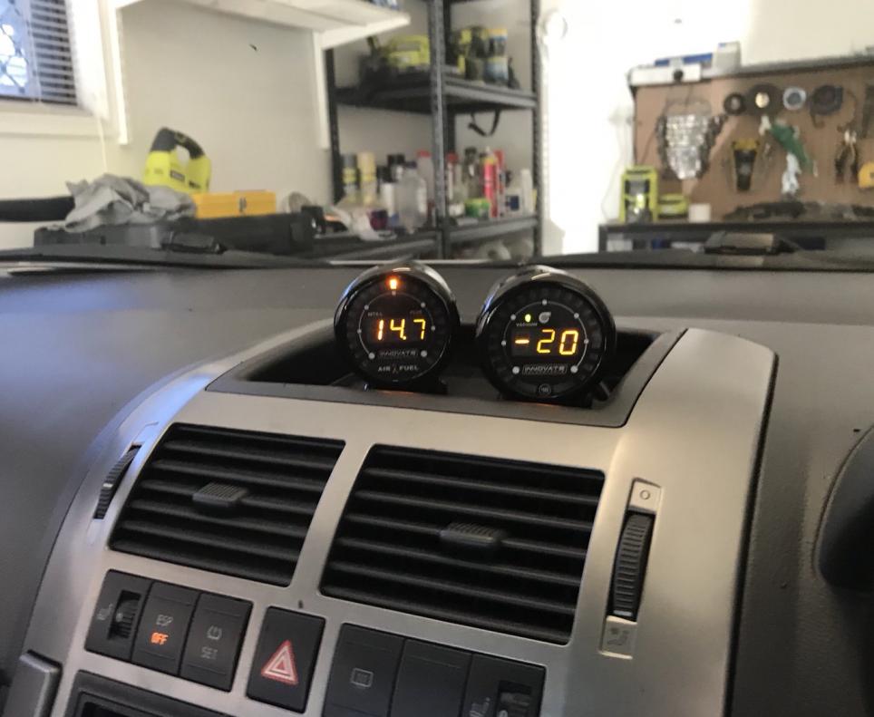

So, clocked up about 2700kms on the polo now. We are closing in on finalising the tune now and it’s starting to really rip along nicely. This week I needed to buy a 4 bar MAP sensor as I didn’t realise the ECU can’t read above 22.5psi on the stock sensor, so that will go in and be scaled in, followed by upping the boost so we can work on final parameters.
AFR gauge installed, a matching boost gauge and a few other “bling” bits as well.

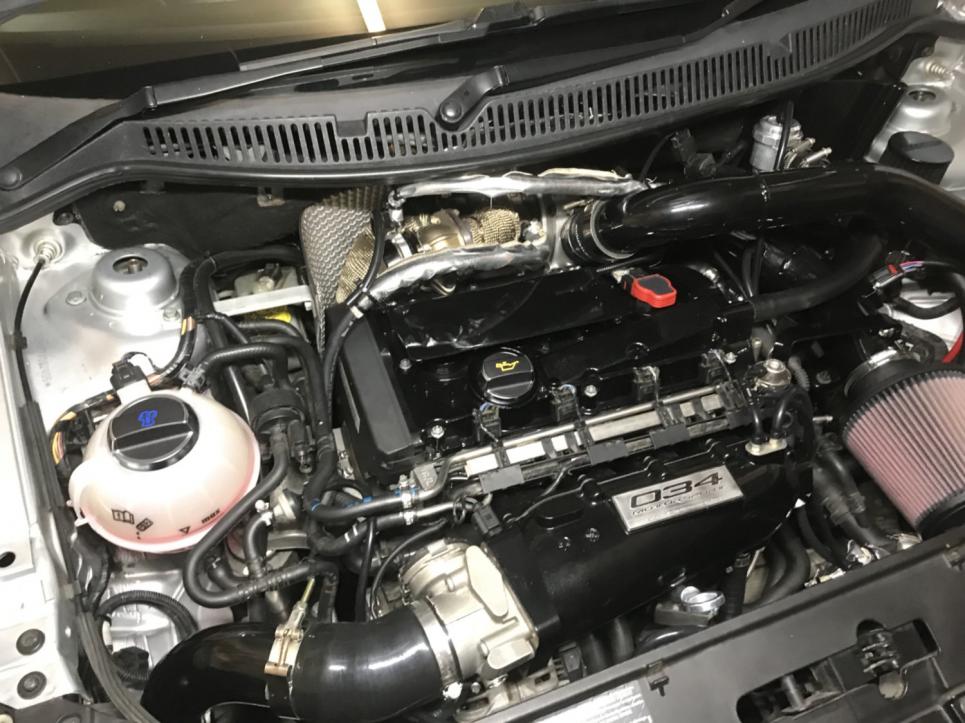

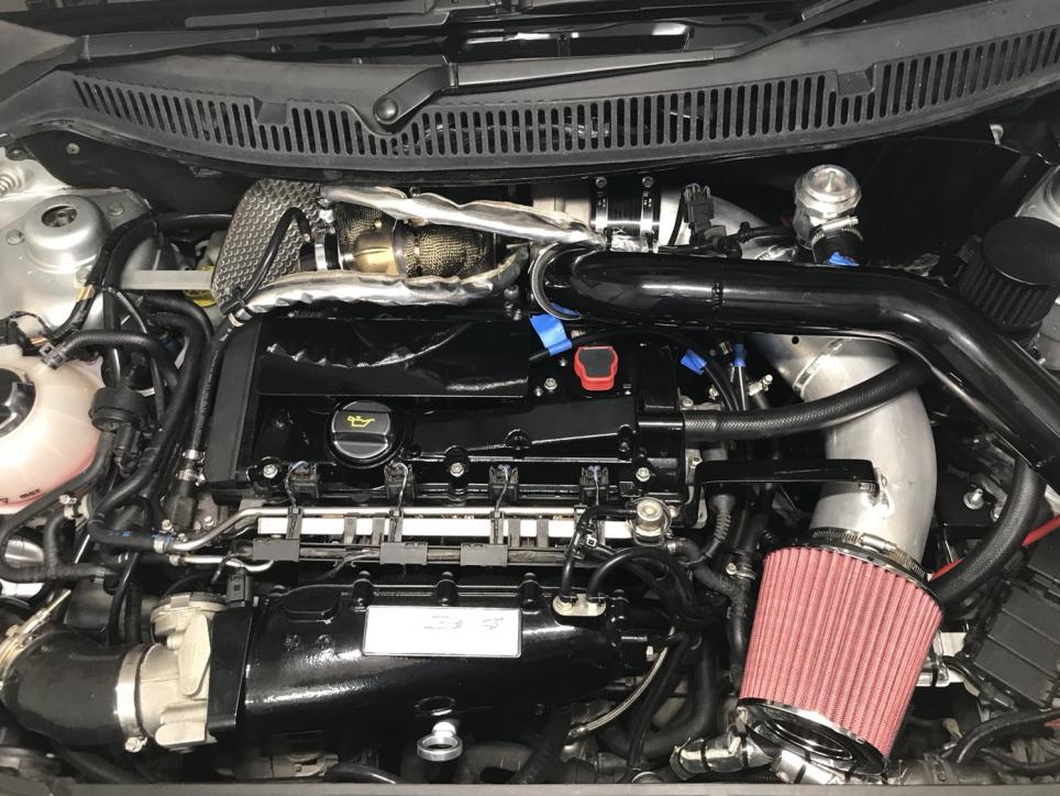

Originally posted by sambb View PostHey Louis, any chance of a pic looking down from inside of the engine bay that shows where your intake pipe goes out the front between the radiator shroud and the headlight?

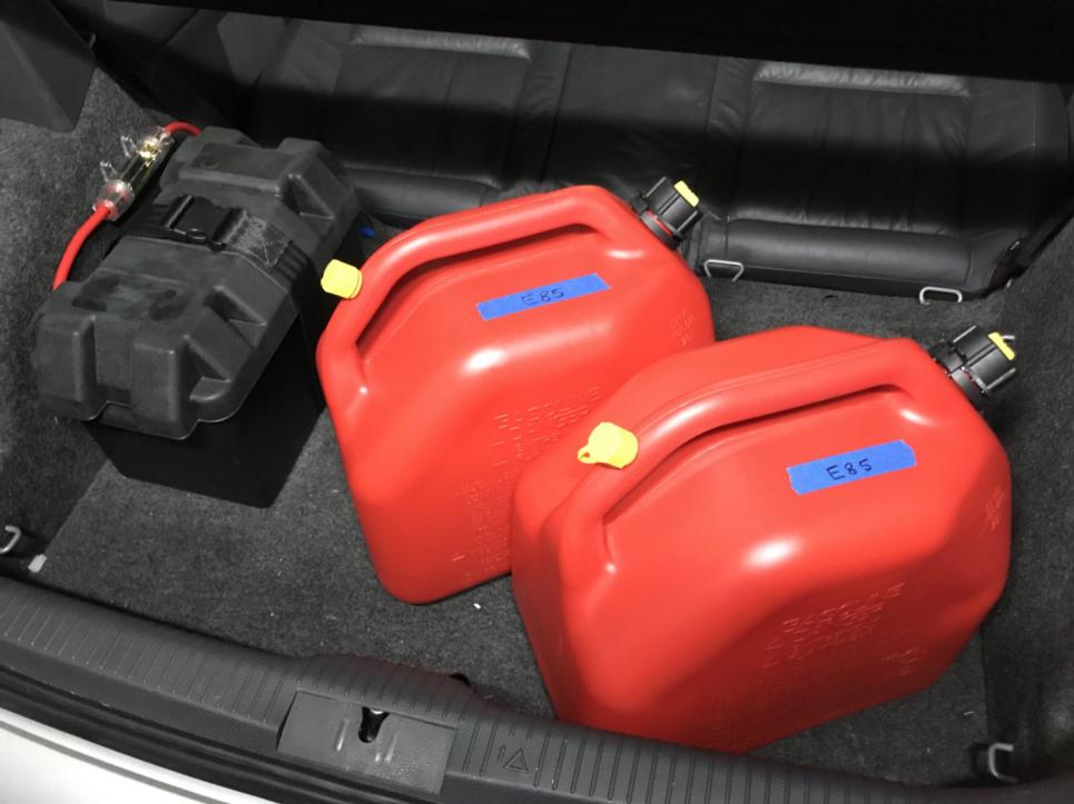

Polo has turned down a new path for its final phase of this setup. In the end I decided to get a Link G4+ ECU for a few reasons, and will be locally tuned on a dyno by a very well known tuning shop. It’s also going to be running on e85 and a mafless setup so there’s a few things that need to change for this including a new intake which I’ve made a 4” one to match the size of the compressor inlet housing.
The car goes in next week for the tune so I’m prepping the last few bits and pieces before then.
