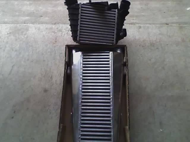

      Here is a comparison between stock and the FMIC. See the diffrence in size......
      Imagine how much better the 1 is over the other ....... all that core exposed to cool air free flowing over it right at the front of the car....
