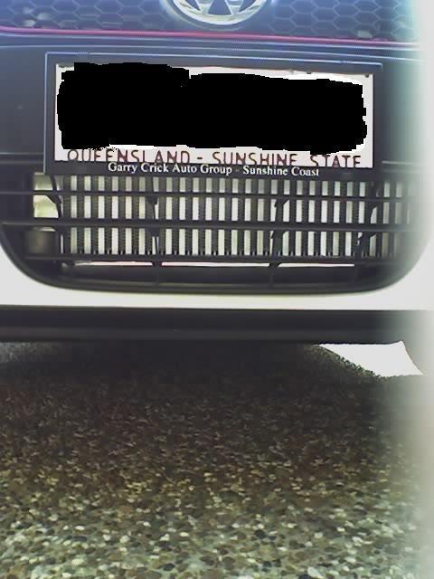

      Essentially you need a FMIC about 50cm in length, 30cm in height and 10cm in width to be able to fit comfortably behind the bar without any cutting. This is about 2.5x bigger than standard.
      The one I found is 47x30x9 and in a side by side comparison with APR's ( about 49x30x8 ) looks to be of similar quaility. The tanks are cast and polished and on the inside nice and smooth. The manufacturer promised excellent flow with figures similar to APR's.
      I'll post pictures on Mon morning when I get to my USB cable for the phone at work. I'll also start tracking down the manufacturer as its been more than 6 months since I bought it. Had too many other things to do 1st so it had to wait before fitment.

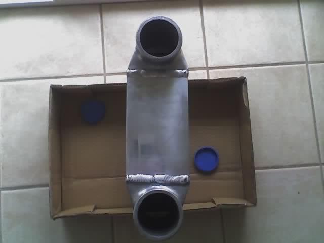

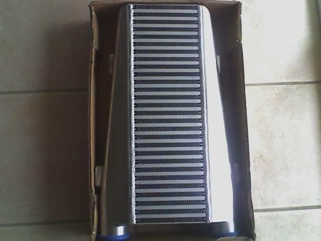

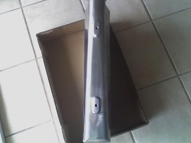

                    Some pics.
                    I'll try and get hold of the manufacturer to see if he has more (can get more) and at what price he'd willing to sell to us lot. Now that I have confirmation that it is a perfect fit it seems like a good option.....

                      Looks nice.

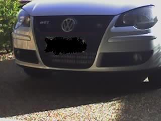

                          Johan you baller! Can't wait to see that shiny cooler behind the bumpers...

                            It is in now and WOW .... the intake pipe is actually cool after a drive.... It used to be untouchably hot....
                            All up well under $1000.00
                            I'll post pictures tomorrow...
