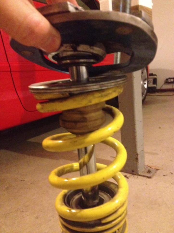

      Did the springs fitted to your car have closed ends ground flat? Click image for larger version
      I think the KW springs on Troy's car need a perch mount that is shaped to the ends so the load is spread evenly

            • KW do recommend using their strut tops, so if looking at the V3's, considering going clubsports to get the tops. Was a $500 difference on top of the $2700 I'd been quoted locally on V3's, so not cheap.
              I'll have a look at the FK springs and Kmac hats tonight to see how that worked as I can't recall.

                  Yes mate, the top hats that were on the FK's were the wrong size for the H&R's. I think the FK springs were narrower, so a smaller top hat. My timely alternative was to source the factory tops.
                  I'll measure it and if appropriate take photo's tonight for you.
                  Daily: 2010 VW Jetta Highline
                  • See pic below of the Kmacs on the FK strut. The top hat does sit flat on the spring, like the pic Kaanage showed above. There is now evident warping of the kmac tops. Let me know if I can help further.

                        • This was the reply from Kmac
                          "Your pics show the bottom blue alloy clamp plates are warped (where stud connector locates).
                          Means over tightened. As per instructions tightness required is only 25ft/lbs.
                          25ft/lbs withstands massive 400lbs of side thrust (3 studs therefore side load of 1200lbs)
                          Simply remove bottom plates, tap again flat and reinstall at above maximum torque settings""
                          This was my reply
                          "From what I see in the pic is that the spring does not sit fully flush on the spring perch which has caused a great load on one area instead of distributing the weight evenly"
