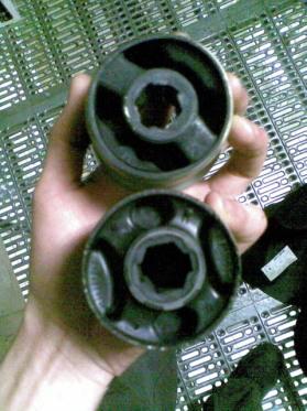

        Edit: Pictures of my new LCA rear bushes. I don't think they're the SEAT model but they're more solid than the ones in my car at the moment, that's for sure.

            • Have a look on the Awesome GTI site, I also have a set of the Whiteline ones in the for sale section, for comparison reasons, or you can buy them pretty cheap.
              • Looks like VW decided the original bushing was too weak, and redesigned it. I can recognise the original as what's in my car at the moment, and I have the redesign to put in:
                Fitting instructions control arm bushing to VW Polo 9N
                New ones look much much stronger. Obviously not entirely solid like the Whiteline poly ones, though.

                      No problems. I'm going to see if I can find a picture of the SEAT bushes to compare -- can anyone help me out? -- and if they're significantly better built I'll pick them up instead.
                      Just imagine the new ones you have with no voids at all - that's the only difference.
                      It looks like the new front LCA bushes a half way to the SEAT ones. Any idea of when the new ones were introduced?
                        Ah, cheers, thanks mate. I might stick these in and see what it's like -- I'm sure a huge improvement from the current shagged bushes -- and if I want more I can go straight to Whitelines.

                        • Maybe you could plug the voids with some appropriately sized chunks of rubber (possibly carved from the shagged OE ones) as a test.
                          I found a thread where they are discussing this changed part on the BRISKODA forum - Is he talking Horlicks?!?!?! - BRISKODA.net - The Skoda Forum and Community
                          In there, one guy posted that he changed from the Cupra bushes to these new ones because he found the Cupra ones to be too stiff and the original ones to be too soft (and the new one being just right). It's dated September 2009 so I guess the part was changed sometime before then but I can't find any other date references.
