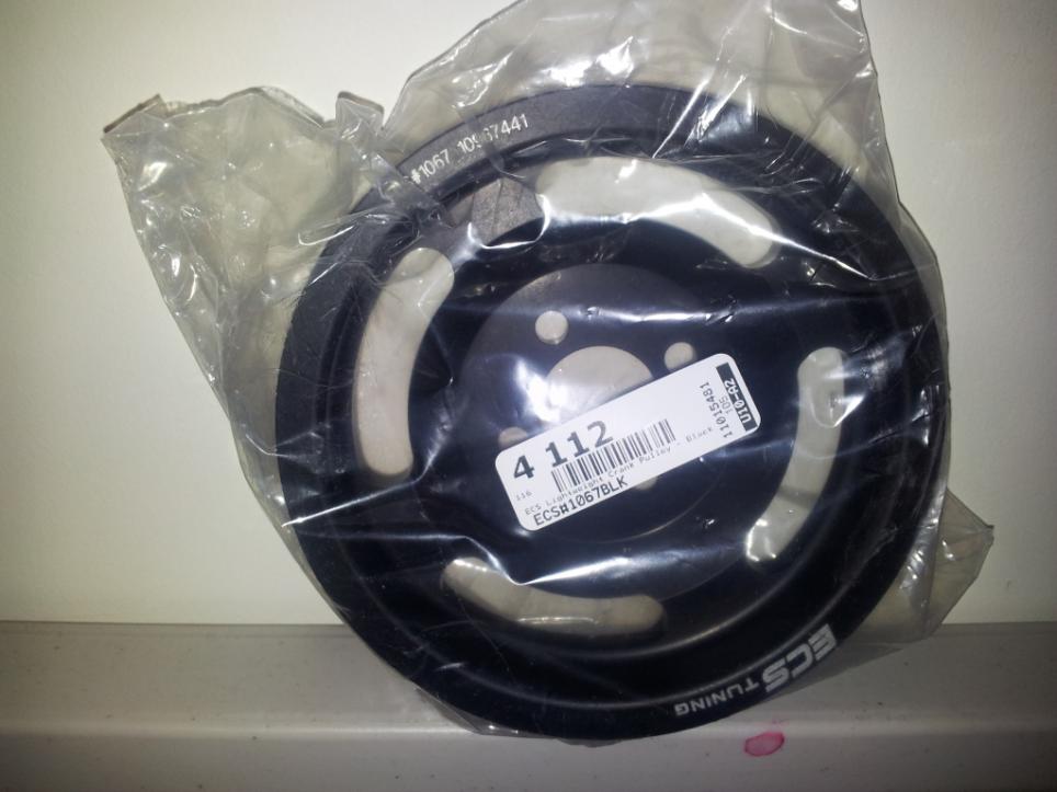

    Just received my ECS Lightweight Crank Pulley and fuel line spacers
    Now need to find a "how to" on fitting it.

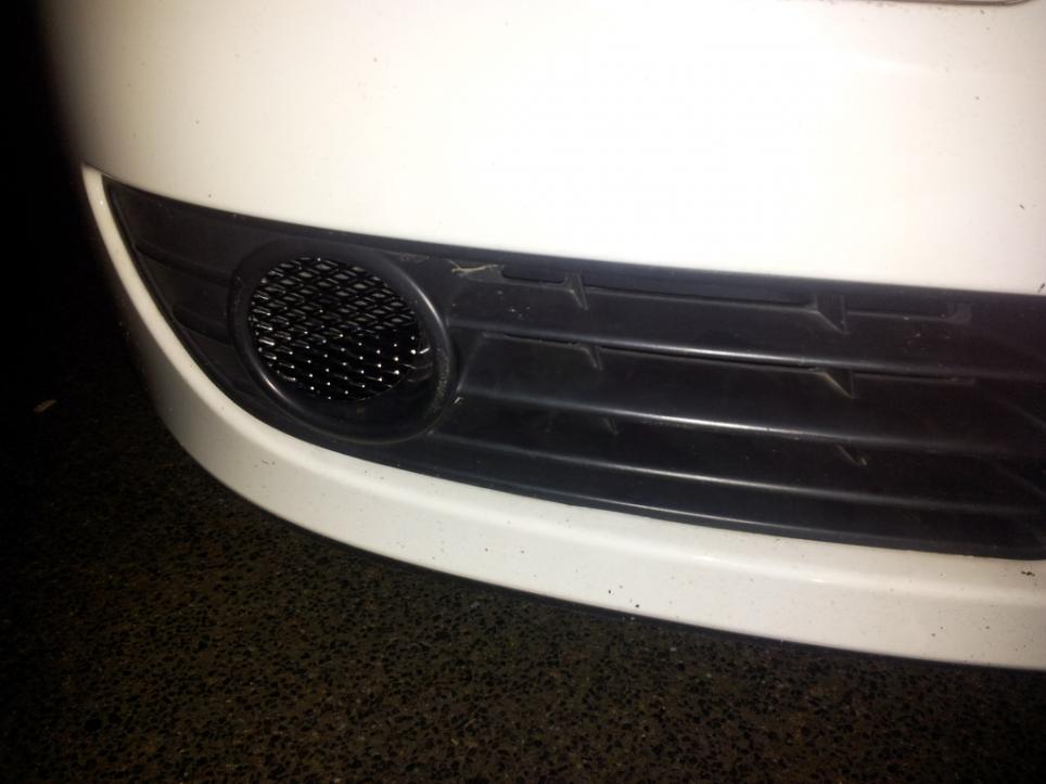

      small cosmetic change...grill where foglights were.
      Polo 9n3 GTI

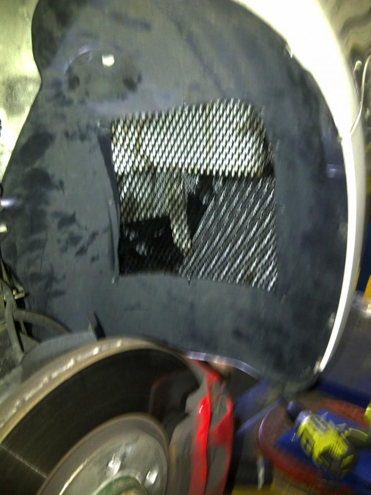

        Nice, done the joey mod in the wheel arch?
        • #49
          Joey mod ?? Please tell
          Polo 9n3 GTI

              Sorry mate, Pikey not Joey, a vent in the wheel arch.
                  That is the next step....although I may do both sides, and guide the air to my front calipers as well

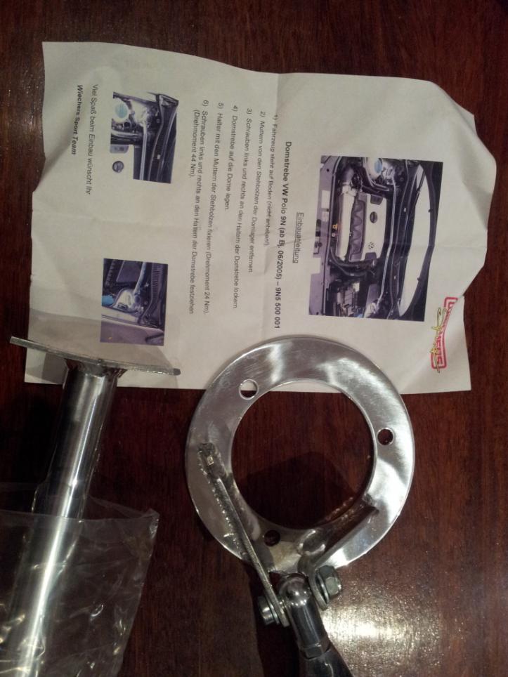

                          Look what arrived...my front and rear strut braces
                          got quite a bit to install now....do you think if i just put it all on my back seat, my car will go faster/handle beter; no wise cracks about painting it red to go faster

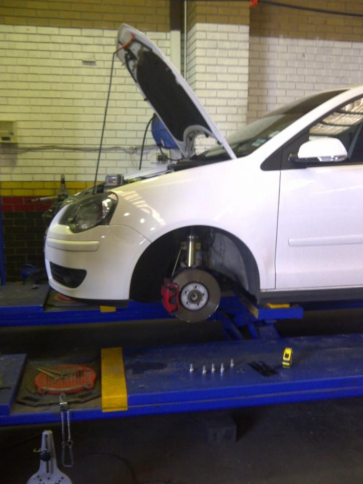

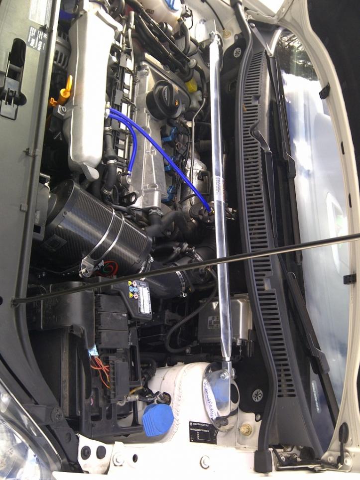

                            Decided to spend some time on my car today.
                            Installed the ECS lightweight pully, and if any of you have done this, you will realise how much lighter the pulley is. It is also quite an easy job. Take you mud guards off, press on the tensioner from above, and pull the belt off. Take the old pully off, and fit the new one..lining up the pulley with a mark. Push the tensioner again, and put the belt on...15 minute job.
                            I also decided to do the pikey...whli Ii had the mud guards off, another quick and easy, just lots of cutting.
                            And then I installed my strut bar...I must say, the car does definetely feel stiffer...
                            Getting ready:
                            The pikey:
                            The strut brace:
