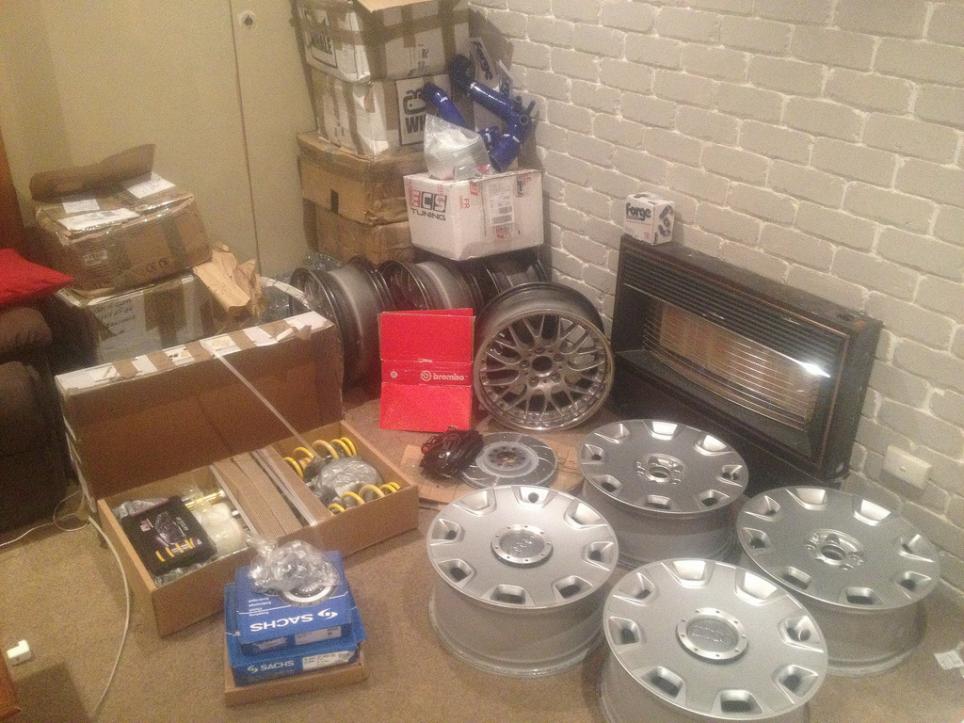

However:
Untitled by night photographer, on Flickr
Ohhhh baby! That's:
KW V1's
Porsche 4 Pot Calipers + 312mm discs (still waiting on adapters and lines)
Forge TIP, TB>IC hose, DV008, Short Shifter
Jabba Sport Cone
Audi Monoblocks (A8 Winter Wheels 5x112 17x7.5 ET40) w/ wrong centre caps atm.
BBS RS740s (slightly hidden, but they're polished to f*ck!!!!)
ECS Clutch Kit + 14lb fly
And a few other bits that are hidden under all the boxes hahaha
