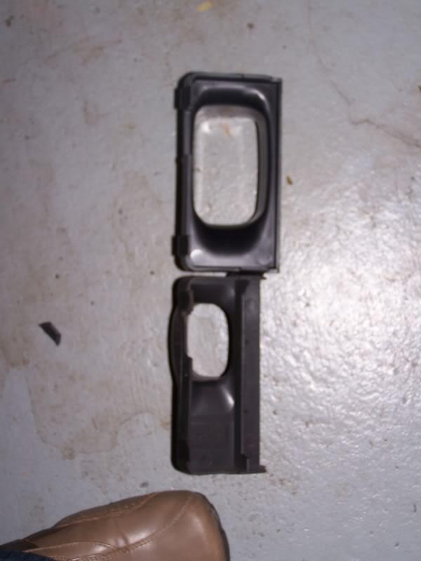

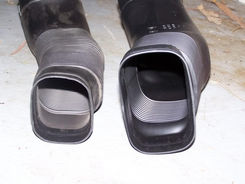

    Here is a picture of the original One.
    And a few Pictures of the differences between the standard one and the Seat one.

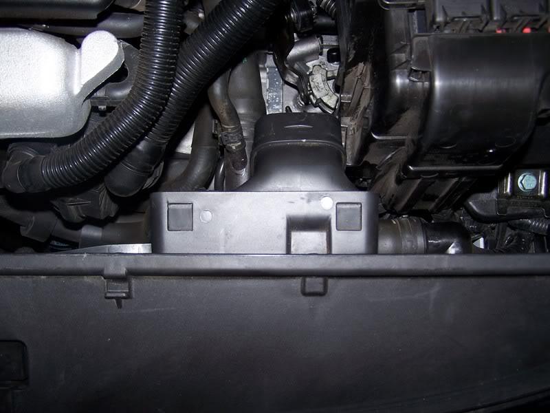

    Now here is a step by step guide.

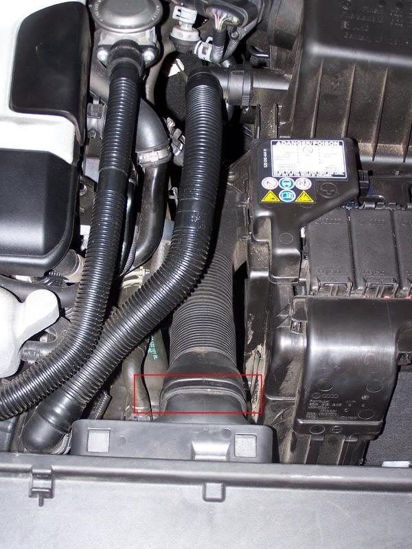

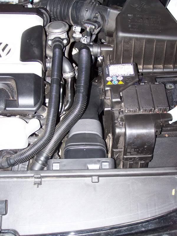

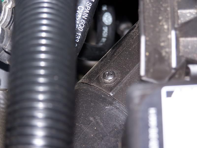

    1. Near the Air Box you will see a screw. (see picture below) Remove the screw. Making sure you don’t drop it.

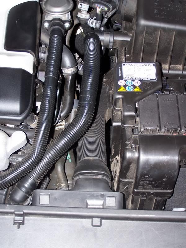

    2. Now you will see a join. (below pic). Pull the Hose section out of the join and then pull it away from the airbox.
    3. Now there are 4 tabs on trumpet 2 one the top and one either side. (Pic Below) Push the Tabs in and pull the standard trumpet out.

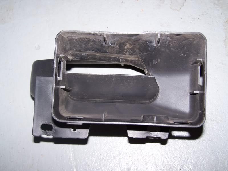

      THE NEXT 2 ARE OPTIONAL. It has been pointed out that the flap maybe there to deflect stones down. But in my opinion they cant get very far anyway. And the Grill should stop most. SO these steps are your persaonal Choice. (PM me your thoughts please.)

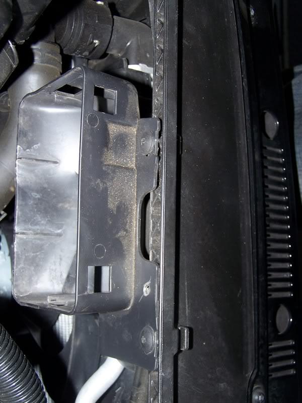

      4. Now you will see the part that the trumpet came out of. It is attached to the front of the car with 2 torx bits. (below pic) Undo the screws and take induction funnel out.

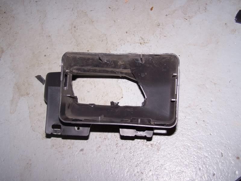

      5. Look down the induction funnel and you will see a flap that is blocking the flow of air. (Pic below) Cut it out with a Stanley knife or something similar.
      And it will look like this.

                  The old looks very restrictive in place of the new.
                    thanks loon, Yeah its at least half the size of the Seat one if not a little smaller. and when you remove the flap i recon air will get force up into the airbox with ease.
