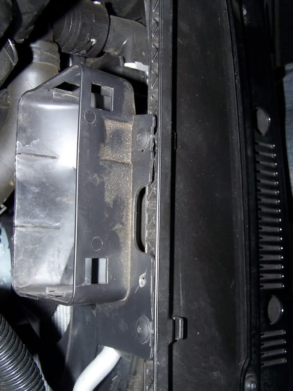

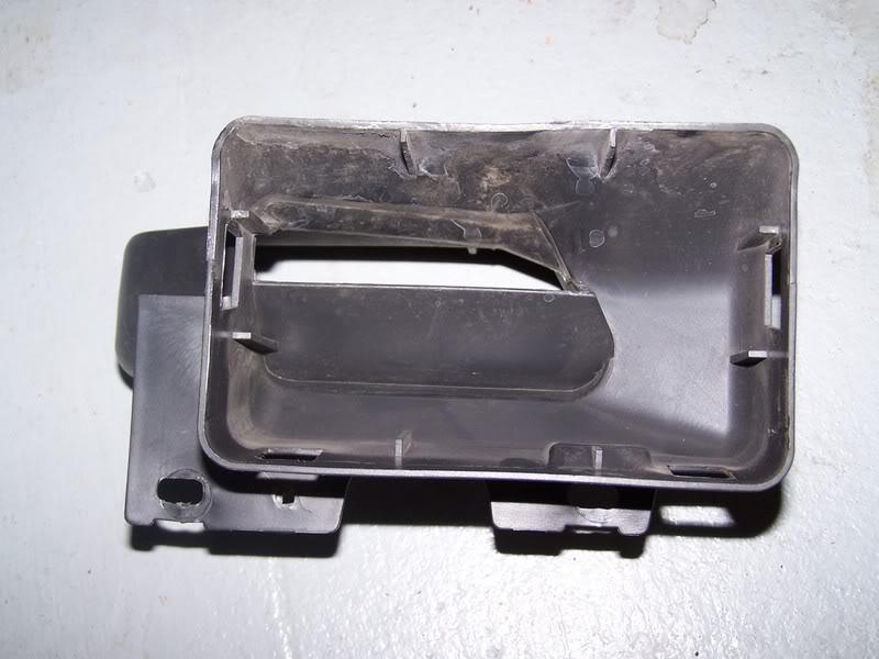

        I know this is bringing up an old subject and all, but can someone tell me:
        Fitting the Seat intake pipe is supposed to free up the air restriction right? However, it's still being connected to this piece of plastic (shaneth, hope you don't mind but I used the pic you took of it).
        So isn't it the case that this is now the restriction?
        Now i'm probably going to get shot down in flames for this haha. However, I think it's a fair enough question. Even when you cut out the flap (which i've done), the air still has to pass through what is still a pretty small hole. I haven't measured the area of that gap yet, but i'll bet a small amount of money that it's about the same size as the standard pipe.
        Any thoughts? btw - yes, there are plenty of threads on the Seat pipe, but I didn't find any regarding this particular question.

        • #49
          hey Mark,
          Mate from memory as its a long time since i did it, once the flap is cut out it is roughly the same size as the new pipe or close to it. If you really want i could have a look.

          • #50
            once the flap is cut, the hole (as shane said) is very close to the size of the SEAT intake pipe. the standard Polo intake pipe has the mouth of the pipe at that opening diameter (shown in that pic) and then significantly shrinks to quite a thin pipe the rest of the way through. The seat pipe starts at that diameter and opens up a bit wider the whole way through. I would be guessing that the SEAT pipe was designed to go with that plastic funnel and the Polo pipe was designed after, saving money and just using the same funnel.

              Ok. I stand corrected - lucky I only said 'a small amount of money'
              Actually, I cut out the flap last week but I've still got the standard air intake. No surprise to hear that it doesn't make any difference - not that I ever really expected it to - although that flap really does look restrictive. I'm going to try and pick up a Seat intake soon and see how it goes.
