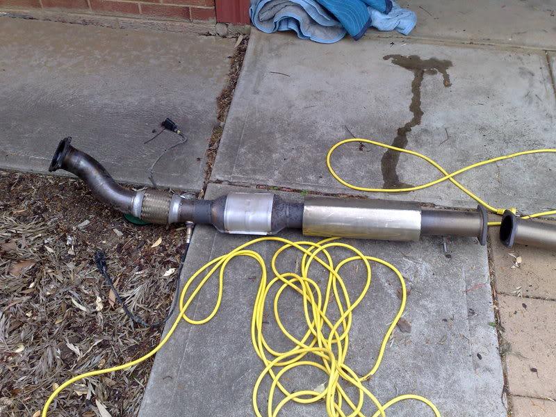

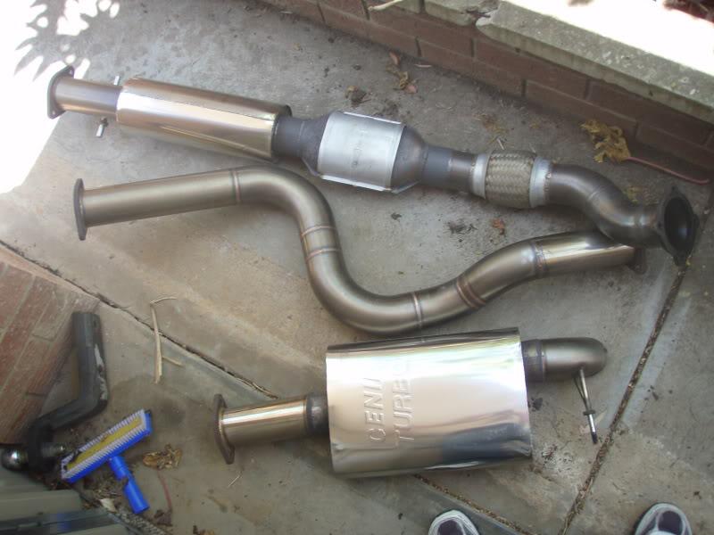

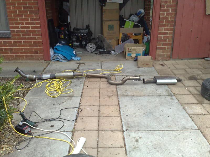

                          I'll happily pipe up (boom, tish!)
                          First, I had a flow test done on the stock system. This found that the most restrictive part of the exhaust is from the turbo to the cat, ie, around the bend. Based on this, my fabricator built a 3" pipe from turbo to cat, and retained the stock cat, which flows fine for the KO3. This gave me a good additional 12KwATW, as measured on two dynos. It cost me well less than $600. I posted a thread on this a couple of years ago. I can't imagine prices will have moved much further in that time. The fabricator has a great reputation in Canberra and used quality steel (not stainless though, unnecessary)
                          Read all about it!
