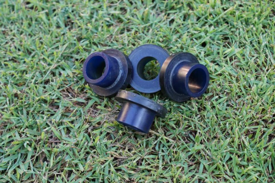

                          • I've made myself a set of these "Sub-frame hanger bolt cam sleeves" - I'm very happy with the change
                            I'm happy to make a set for anyone who wants them, no need for a group buy. Similar money to the bloke who made them for Eddy
                            • Did yours require the subframe to be reamed for them to fit Simon or were they a snug direct fit?
                              • Originally posted by sambb View Post
                                direct fit Sam - I sized it to slot into the subframe
