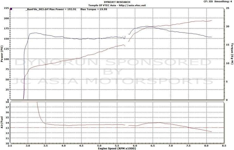

Good to discuss anyways. I do agree with Tosspot in regards to difference % loss on different wheel layout. Having said that, 20% is too much loss assuming the drivetrain are in good condition
Take a look at the dyno graph of fully stock FD2 Civic Type R K20A rated 225PS:
All cars are obviously different, but so are all dynos. Also, many car manufacturers understate their figures while tuners tend to overstate. Which is how we got onto this *looks at REVO*
