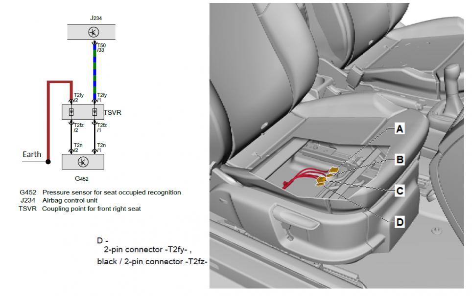

    hey guys<br>after installing the gti seats i got the airbag light.. now i have seen a friend who has a scanner tool and he has tried to wipe the air bag light off. but the problem is it keeps coming back<br>he got an error code on his Creader tool (B102715)... now i have checked all the connections and they seem fine and i have checked that the connectors from the gti seat to the original seats and they all seem to match.<br>i have even taken off the original seatbelt buckle and tried to plug that in and it still comes with the error<br>the only thing i can think of now is the the wires that connect to the connectors. &nbsp;im really stumped&nbsp;<br>any help is appreciated<br>&nbsp;

    Subsonic: Hello. The important words in your description of the problem are "Seat-replacement" and "airbag-light"!
    The only connection (that I know) that links these words together in a Polo is the pressure switch for the occupant sensor.
    Here's a picture of the sub-circuit for the occupant sensor and also a picture of the connectors in the seat cushion. I suggest that you look in particular to the connector marked D (in each seat). I suspect that the problem is caused by either the TSVR connector block, or one of the senders
    Cheers
    Don
