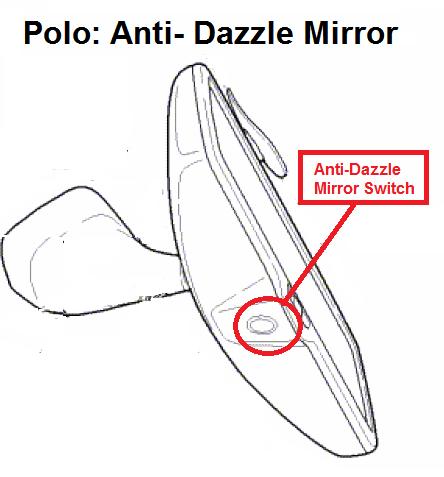

brad: according to THIS, the 2014 Cross Polo 1.2 81kW DSG has an anti-dazzle mirror. So it should have a button that looks like this:Originally posted by brad View Postpost a photo. Sounds like it hasn't got it.

Thanks DV52 for actually looking that up! Yes, of course it has the feature, there certainly is no manual means to tilt the mirror and both sensors are present.
But it has neither the button nor the other feature just near it which I assume is the indicator light. The rear-facing sensor is at the top edge of the glass. Clearly it's a new design, the car is only a few months old. I can't find any setting anywhere in the Composition Media, or a button on the overhead console or the dash. Presumably it's fully automatic.
