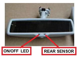

              KiwiME: The anti-dazzle mirror in my Polo looks just like the unit in the pic below. Rear sensor on the bottom RHS (you can just see the button on the bottom of the housing in the pic)

                Awesome, thanks for the photo. The rear sensor on mine is near the top-centre of the glass. I'll have to check next time I'm out at night but I think they've made an error by moving it to the top.
