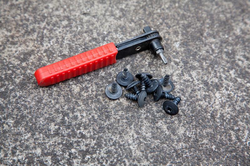

                                After jacking your car up on stands, you will need to remove the plastic underbody panel.
                                There are 9 screws in total and you will need a hex tool.
