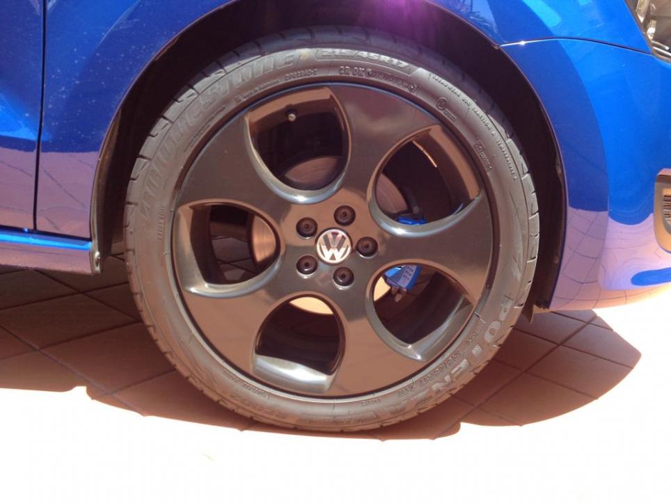

      • Did this today. might not be everyones taste but i recon it looks pretty sweet
        Also found an excuse to buy some coilovers. turns out ive manage to dent the shock casing one the front right. i have noticed a knocking sound recently. Awsome, now i can justify spending money on some new ones
        • You run 215/45 tires? Doesn't that put off your speedo?

              Maybe, wouldn't be by much I would think
              • Tyre will be 22mm higher increasing ride height by 11 mm and with the speedo showing 60km actual speed would be 58km so not much difference.

                • Yeh that's what I though, thanks lunchbox. GTIs run On 215/45 from the factory don't they?
                  • 215/40!

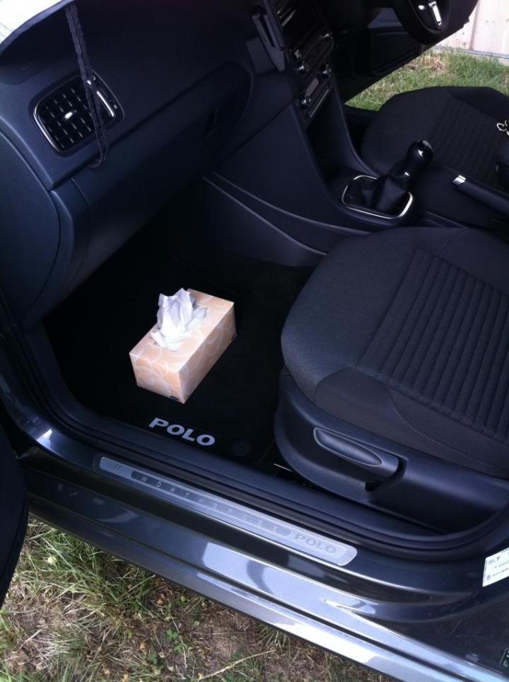

                      • Door sills the other day

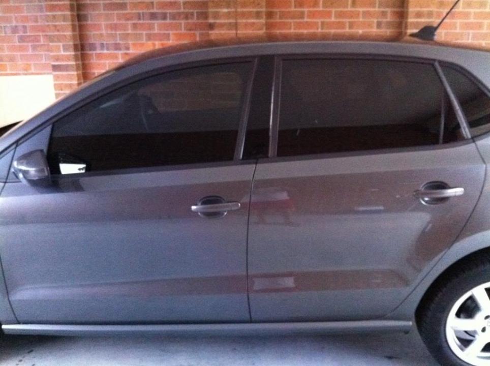

                        tints today, 35% fronts, 20% rears

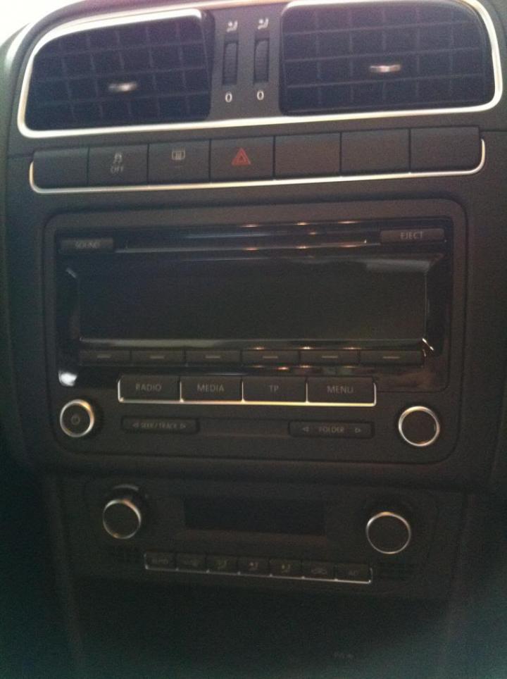

                        took out the rcd310

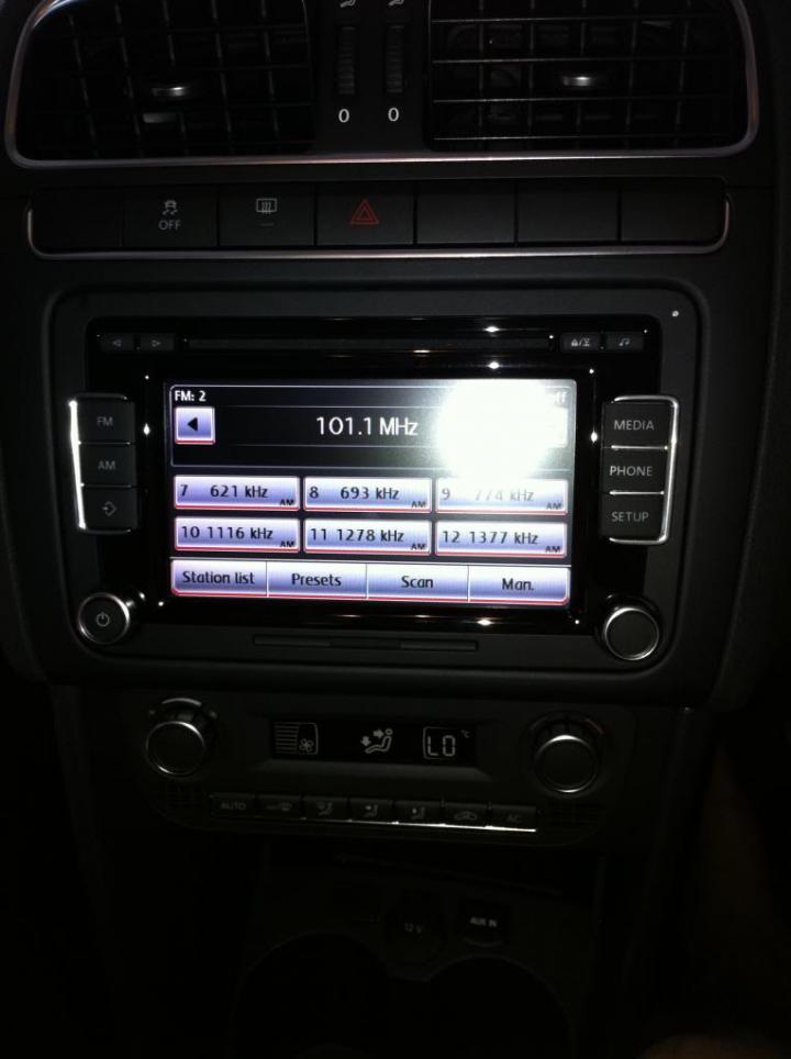

                        and put in an rcd510
                        the 310>510 swap couldnt have been any easier, literally took 2 minutes. just pop a butter knife in the top corners, they pop out, and the rest is obvious. no scratch marks either
                        • Interesting Kam, I want to do a swap to the Rns510 too, glad to hear it was easy. Where did you get it from? How much?

                            just to confirm, i put in the rcd 510, its the touchscreen with 6 cd stacker
                            the rns 510 is single stacker, and has gps lady
                            its a bit more messing around with the rns, since you need to connect up the gps antenna etc
                            i got it from this seller on ebay, picked it up from him no worries. its brand new, the buyer of a golf optioned to an rns, so they took out the stock rcd, he has some sort of connection to a vw dealership
                            eBay Australia: Buy new & used fashion, electronics & home d
                            i also should mention that damn! does the headunit make a difference to sound quality! if i told you i upgraded every speaker and put a small sub, you would believe me. the quality is amazing, and the bass is so much deeper, i was honestly not expecting that at all!

                              I wouldn't say more messing around the antenna takes another 5 min unless you run a cable to the shark fin.
                              Lemonskin - if your after a RNS talk to Martin at www.jku.com.au he is a sponsor on the forum and gets them from the factory check his thread http://www.vwwatercooled.com/forums/...age-74298.html
