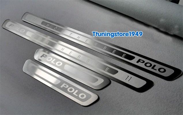

    • got my door sills in the mail today
        Looks great. Does anyone know where I could find a cheaper-than-dealership boot sill protector from? When I finally get my bumper replaced I want to keep it scratch-free.

          • Originally posted by alexaescht View Post
            i just keep a spare piece of cardboard \ cloth in the boot, which i throw down when i have to drag large bulky items out of the boot
            • Originally posted by kam View Post
              Not a bad idea actually...

                • i do believe i have seen some boot sill protectors, stainless steel things, just like the door sill protectors, however it looks heinous!
                  We need some thing that stows away!
