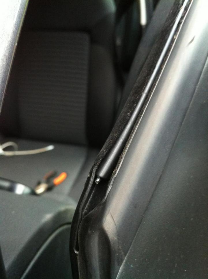

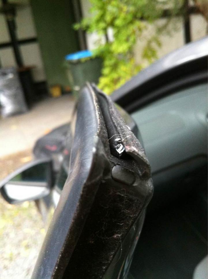

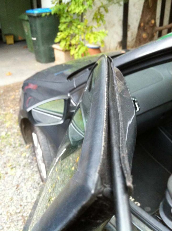

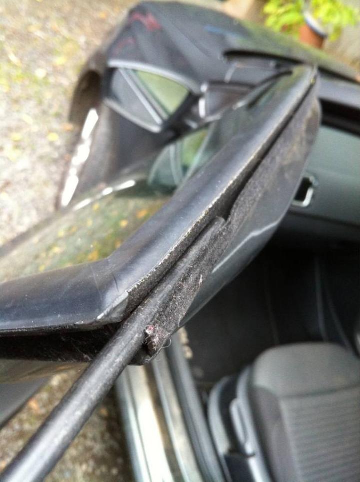

Tube should be around 6mm diameter.
Just cut it to length and push it down between the two strips of felt seal.
I've just tested the tube vs. no tube and I can say it does make a slight difference, however my Polo's seals weren't very noisy to start with and it's difficult to hear the noise they make over the diesel clatter.
