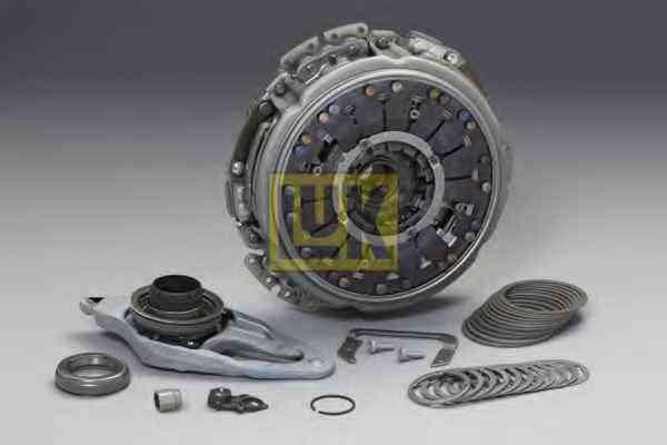

With our clutch problems the actual clutch material is becoming soft and been ripped of the clutch and in some cases getting stuck to the dual mass flywheel due to excessive heat (climate?). this is leaving glazed and elevated spots on the clutch which don't transfer torque correctly and thus the slip/shuddering, but the clutch hasn't compleatly been worn down all the way.
