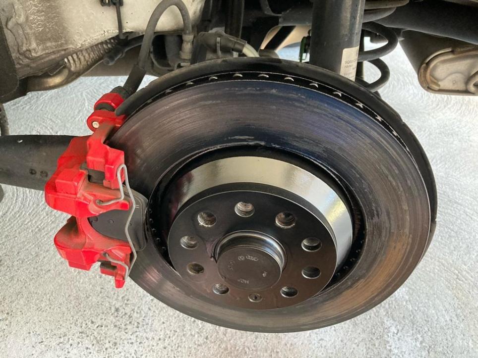

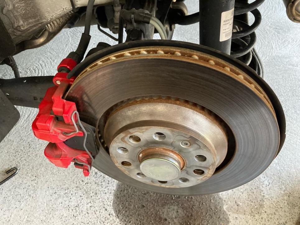

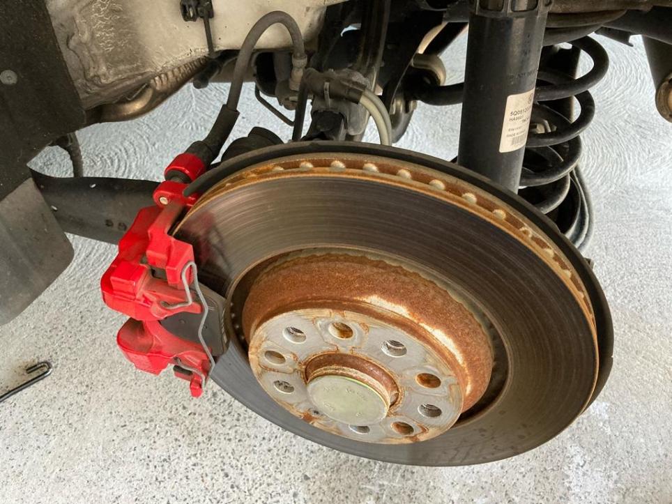

    I always paint the hubs on my cars because the rust looks horrible. Refer the pics below of the process on my car:
    Before:
    After using wire brush:
    After a coat of satin black paint:
